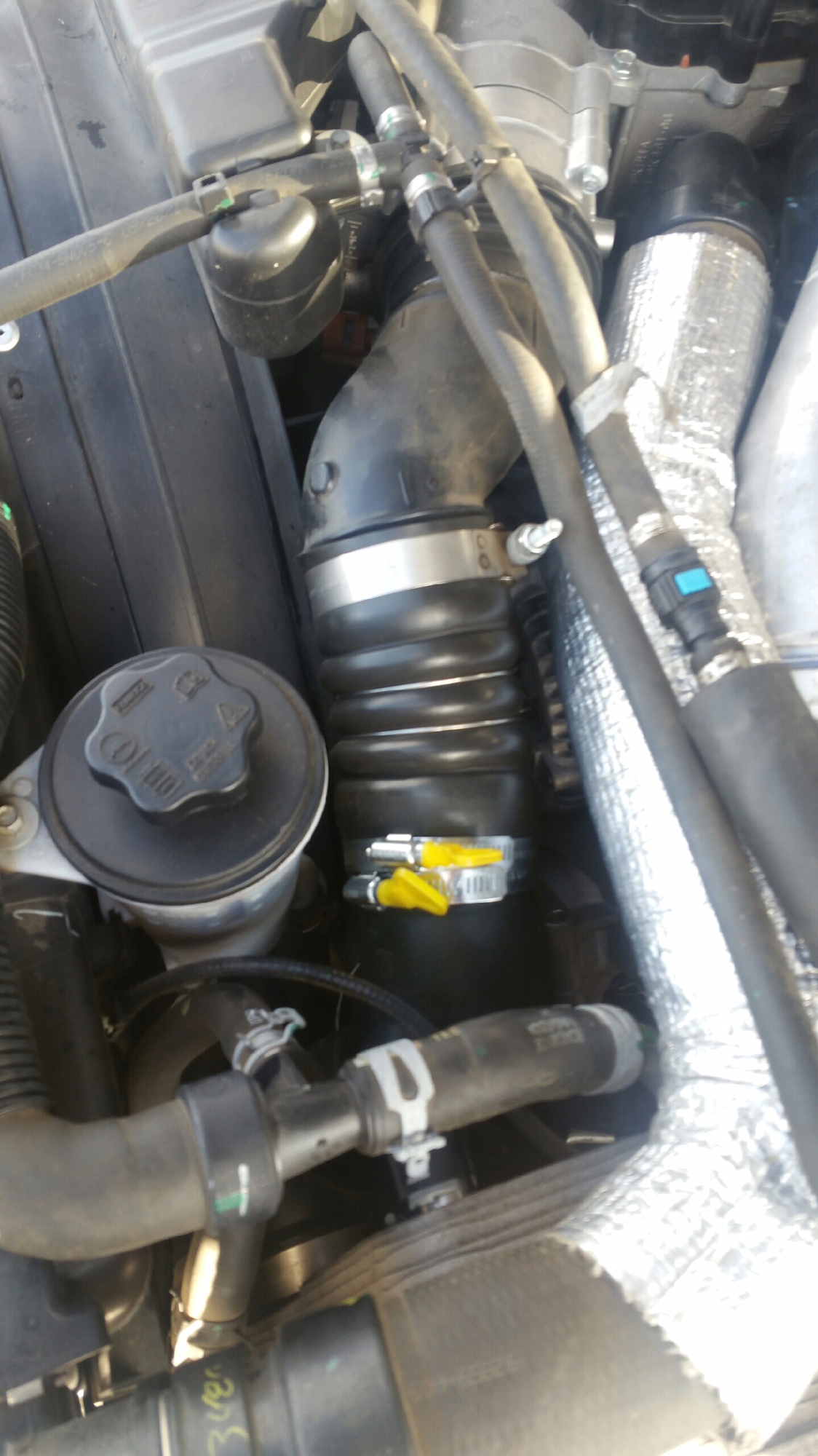

Just got off the phone with him. It was in fact on the cold side but it was the lower (closer to drivers side) clamp. Non adjustable clamp is how he explained it. I told home to find some hose clamps to get him by for now.

not sure that you and him are on the same page. get him to send a pic and post it here.

He just blew it again. Ford in Canada says 10-14 days. He was putting the clamps back on and found this ring. He's asking if anyone knows what it is???

If he is headed for Portland, have him call ahead to Vision Diesel in Donald. They are about 30-minutes south on I5. He needs the H&S replacement part. There are 2 versions. One for stock and one for tuned. They should be able to put it on for him.

Is it me or does it look like the ford engineer was walking through Home Depot, grabbed a few pieces of ABS pipe and said "this will save us millions!"

no offense, glad he gettin home. BUT, call mike get replacement part from h and s. They pop all the time. not worth the headache next time. very common, no rhyme or reason. not a time or mileage thing

The OP's dads truck will surely do it sooner than later being that he tows a 43ft 5th wheel. It's the heat soaking of the plastic that causes it to blow...
Like mentioned by Big Juice, get a metal replacement pipe...
