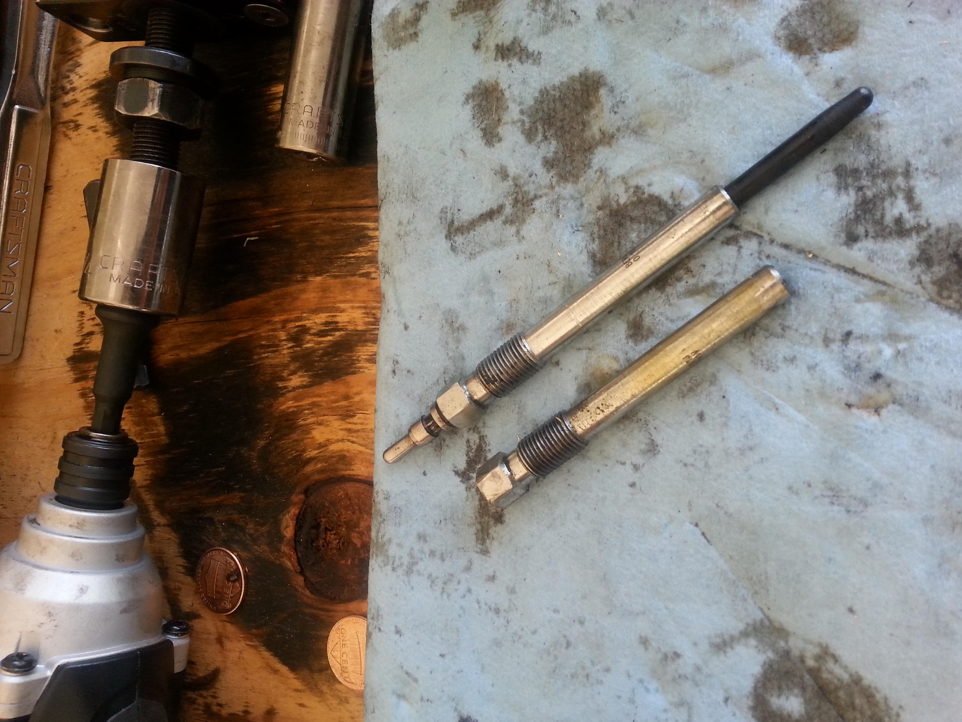

So I've been working on my GF's brothers 02 truck which is a bit of a mess. He has a cattle farm and logging business and is always busy. To say its been rode hard and put away wet is an understatement. I'm in the process of doing injector cups, injectors, up pipes, oil cooler, and addressing various oil leaks. I spent several hours washing off mud, cow crap, and 14 years of oil build up off it so I could see the motor. Once it was cleaned up things were going smoothly... too smoothly and I knew it was a matter of time before I ran into a headache. I went to remove the last gp from the passenger rear cylinder and only part of it came out. As soon as I saw it I was sick. The electrode is still sticking out but won't come out. I filled the bore with PB blaster put some needle nose vise grips on it and tried to pull it out. I tapped down on the vise grips hoping some downward movement would help break it loose then pry it out, but nothing. I've worked on it for hours and it won't even wiggle.

have you tried bumping the engine over to push it out?
^I was thinking the same....see if you can blow it out. Keep working the thing up and down with a hammer/vice grips too.

I put the interior back in and turn it over by hand. No luck. While it was soaking in pb blaster I continued on to make progress elsewhere and pulled the injector cups and other parts so I can't repeat that. I tried again to break it loose this morning and still nothing. I've got about 5 hours spent working on it, so I'm not going to waste any more. Hell I could have pulled the motor by now. With the motor out ill save an hour or 2 with the up pipes same goes for the oil cooler

I'm going to try not to pull the head. I've got a vise grip slide hammer, hopefully that will snatch it out. In the event that I do have to pull it should I send the head off to be rebuilt? The truck has 280k on it. Also the head bolts at tty correct?

I had to drop the trans because it is a 6 speed and there isn't enough room between the oil pan and cross member to pull the motor forward to clear the clutch of the bell housing. Once I got the motor out I put the valve covers back on and plugged up all the holes to pressure wash it. I put the slide hammer to the GP and after at least a dozen strikes its still not budging. Eventually the tip of the electrode I had to grip onto broke off in the vise grip jaws. I called it quits after it started pouring out and the wind started blowing it in sideways into the carport. I'm going to get a few things cleaned up an organized before I pull the head.
