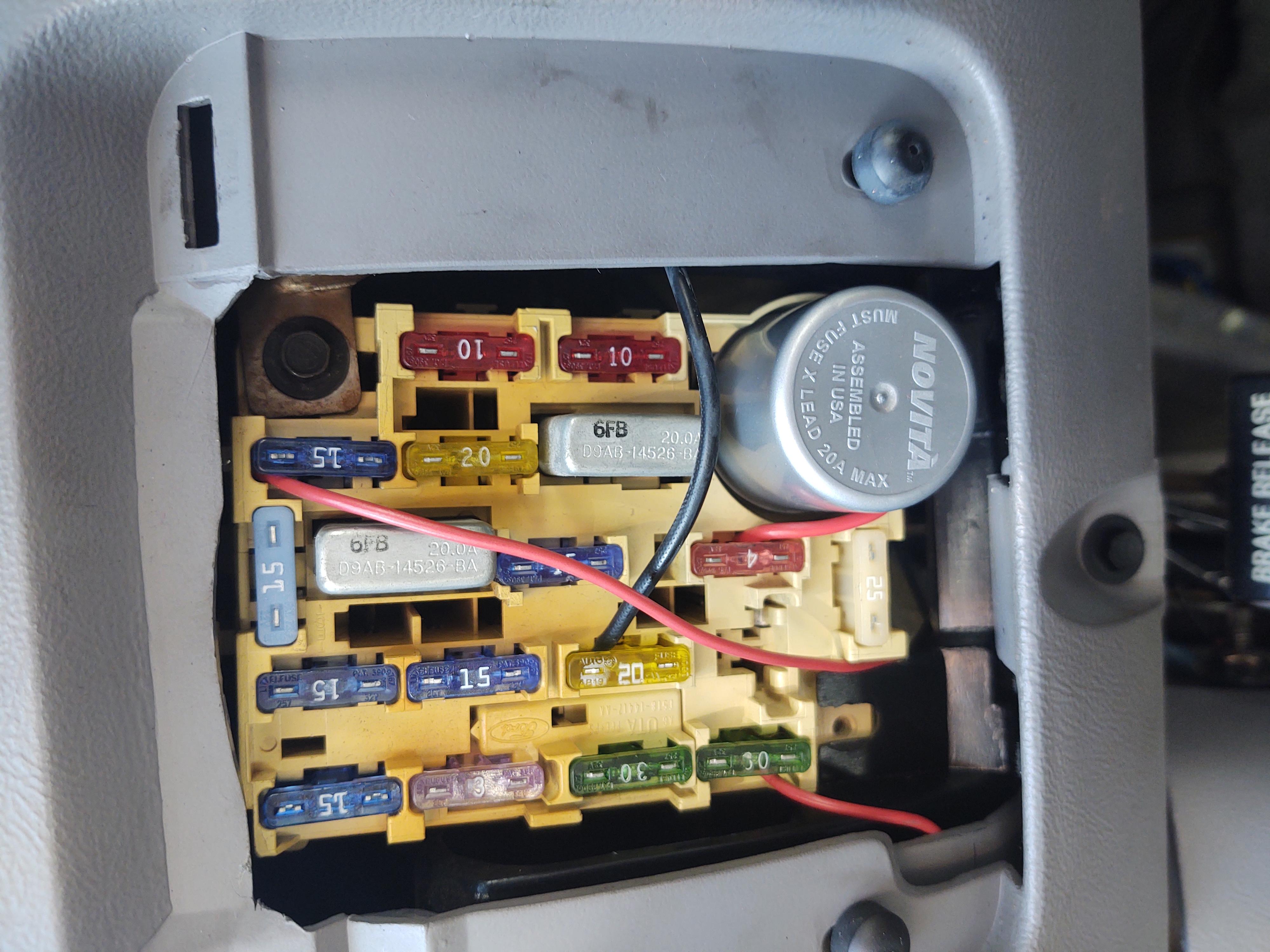

Where is the second flasher that you are talking about? This one is in the fuse box on the dash, but there are no flashers in the one under the hood. Thanks!

Ok so I switched the flashers around from back to front and vice versa with no help. Still have left blinker and emergency flasher, but solid lights when right blinker is engaged.
