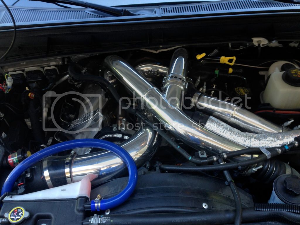

Another vote for MPD turbo kit running the s365 stock fuel for now dual fuel on its way rite now. Also running Craig's motor and transmission tuning. Runs great only drained the rails once and it scared the chit out of me so I turned it down some. Power feels awesome transmission tuning maybe a little stiff for some but with traction bars it's fine. Seems to never be in the wrong gear always keeps on top of the turbo so the smoke is very minimal even on a big tune.
Looks a little different now I've put a no limit intake on it.
