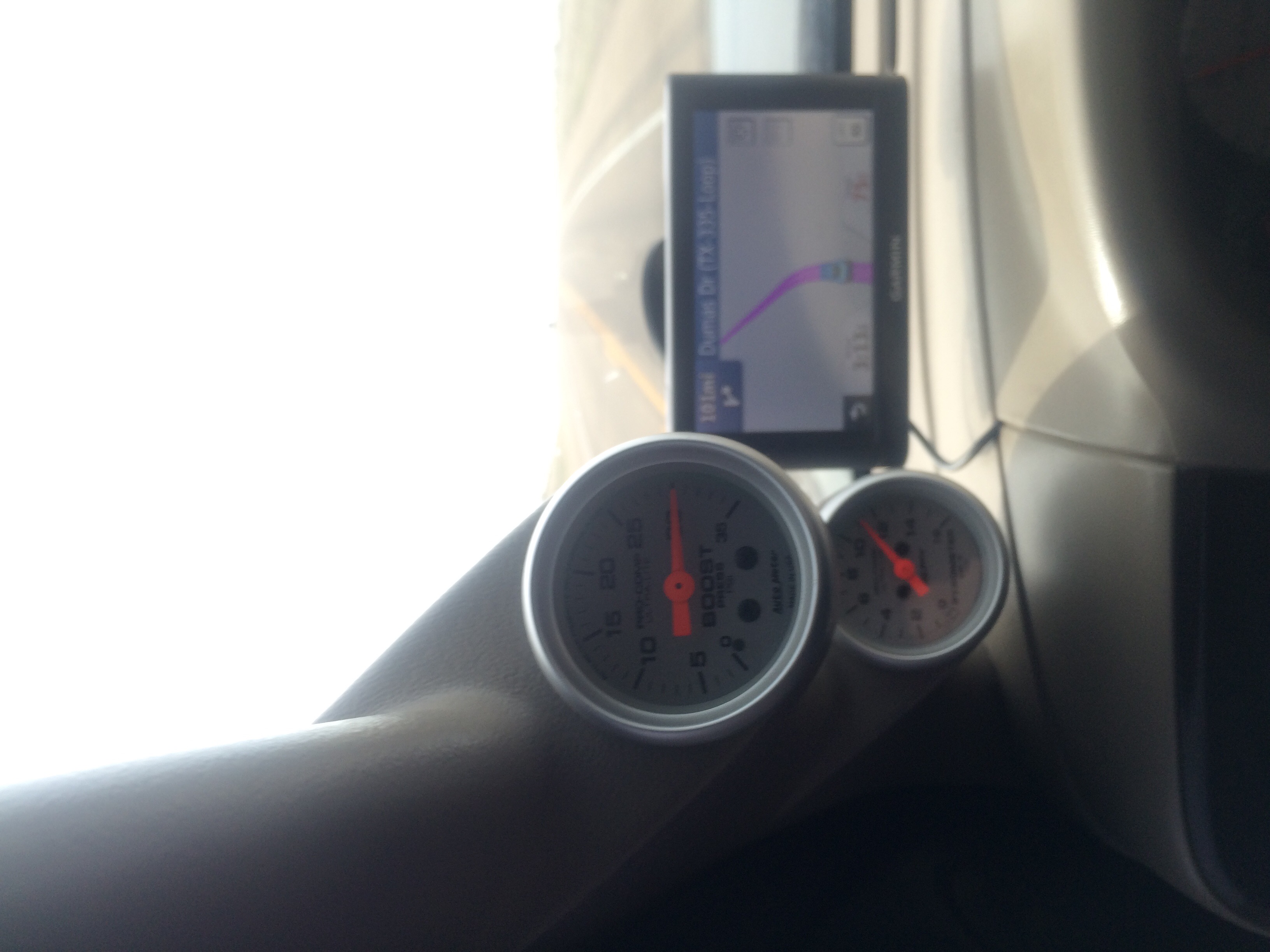

Trying to figure out if I have maxed out the turbo or my nozzles.
I have a powermax with single plain wheel and 75/30% injectors.
On my big tow file locked in overdrive I get 35 psi boost by 1700 and it drops off after 2500 rpms, it will drop to 26 by 3000 rpms. Egts will hold 1300 from 1700-2400 then start to climb, up to 1600. It's smoke free too.
Not sure if the nozzles are to small to push the turbo or if I don't have enough turbo to push air up top.
What do you'll think?

35psi by 1700rpms? That seems a little crazy. Was that with a big load hooked up and rolling into it at really low rpms? That is pretty far off the comp map and would usually result in surging???

That's with or without a load on it. It's smooth power, has a ton of low end power with that combo. I normally run the tow and atlas 40.
It's the only combo I hane found that has power in the 1700-2000 range. Keeps all the temps low. Egt, water, oil and tranny.

My bad on boost, with the atlas 80 it is 30 psi at 1700 and 35 at 2000
Not volt but I see 3900 psi at wot. Think I have 2800 psi at 2000 rpm.
Back pressure is 38 psi.

Those all sound pretty healthy. DO you have a mechanical ebp gauge? I dont think the pcm can read past 38 or 39.
