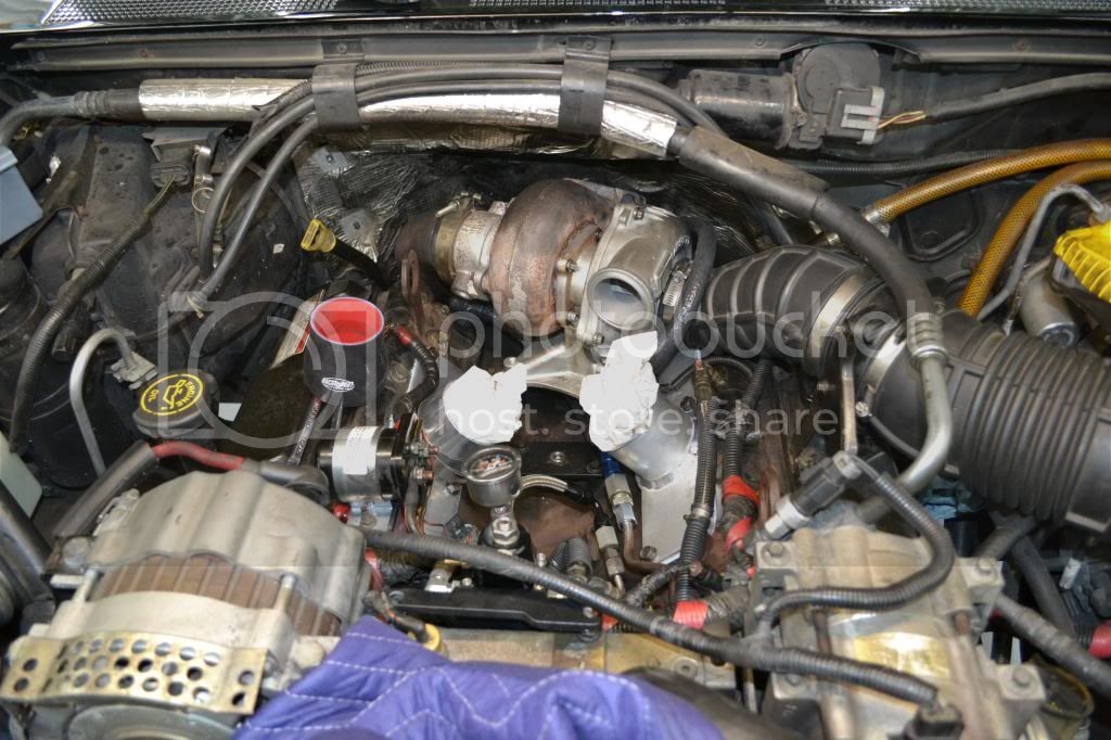

Yes, Irate's are the only ones that I know fit the OBS. The Irate intakes are flat.
The last time I spoke with Jake (Irate), the intakes have been re-designed.
You need to get reducing couplings for the spyder.
Use only the gray RTV from Ford or Int'l to reseal the intakes.

The RiffRaff has a stepped design. I spoke with RiffRaff and they stated theirs do not clear the OBS turbo compressor. The OBS turbo has a shorter pedestal compared to the SD.
Couplers are generic. Need a 2 3/8" x 3" coupler which is an odd ball size. I used a 2 1/2" x 3" coupler which is more common.

Just bolted them.
The hole design (8 vs 10) is a motor/truck year thing. You can use either.
One of the plenums corners needs to be slotted or slotted. The bolt by the HPOP reservoir can not be removed.

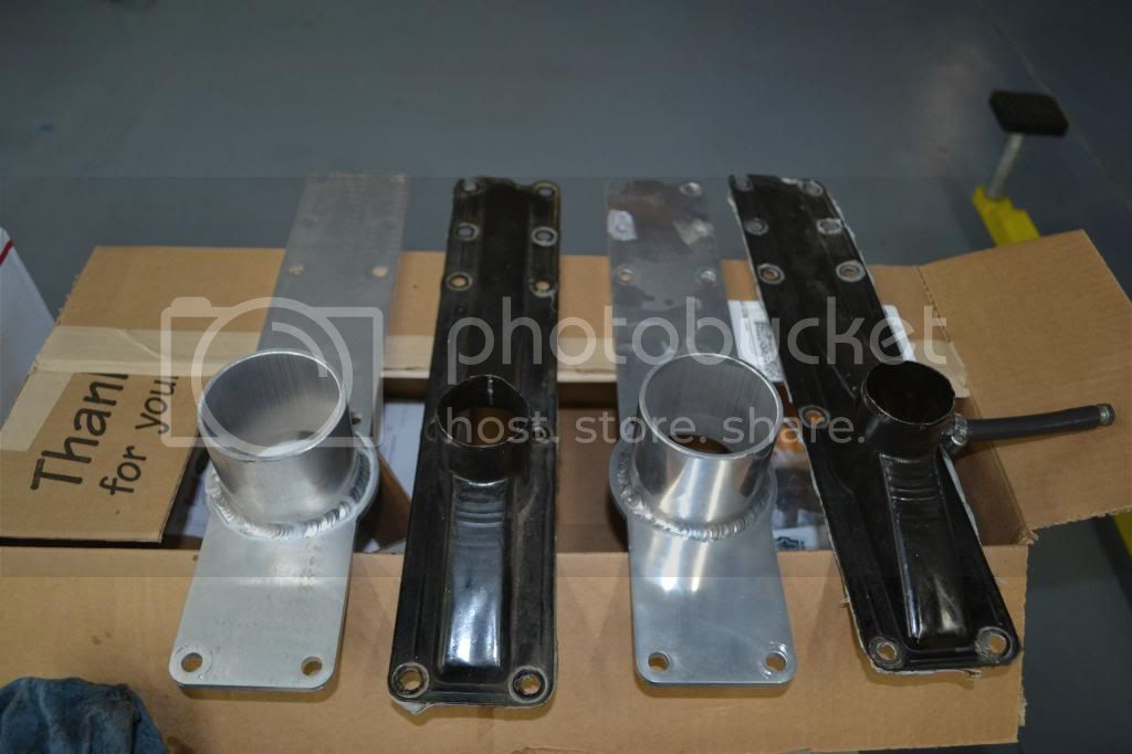

Note:
You'll also need to re-plumb your map line (as noted by the farthest right hand plenum in the picture).
Just bolted them.
Billy T.
[email protected]
I drilled and tapped an elbow on the back of the hot side on my E99 plenum:

Yeah, Sorry for the confusion. I was saying that they are not just a bolt in design and would need the diff boots and clamps. They will fit just fine with the stock turbo!
