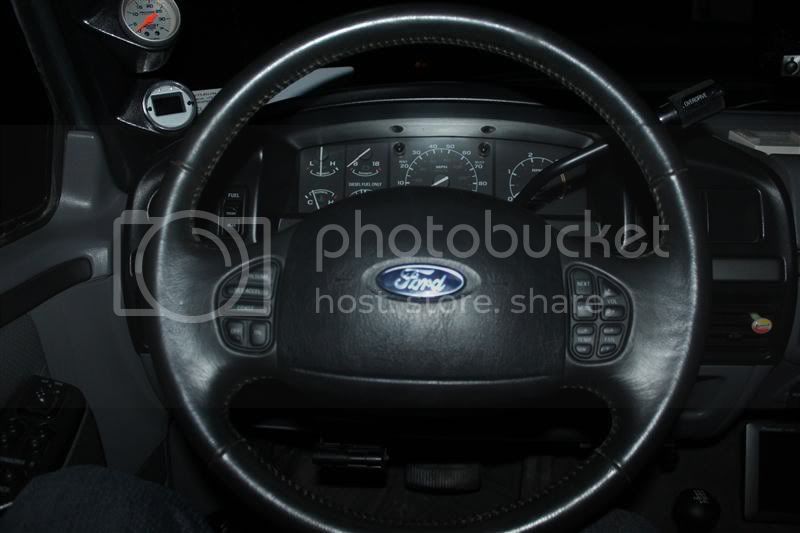

I would be interested in some pictures if you have them or know of any.

I have one its off the nation tho warewierd69 (aka grant) did it

I think it looks great... I'm not sure if he did or not I'm guessing he didn't.. but then again any thing is possible I don't have cruise so I won't need the buttons but I know he got the lights to work...

Yeah, they are functional on the wheel. He used the aftermarket kits that "interface" with an aftermarket head unit in the SD's.
