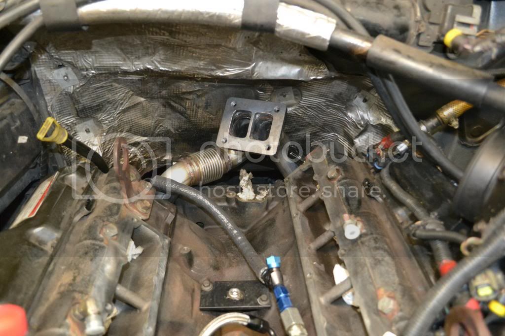

No issues when I was running the Irate one piece up pipes.
http://www.iratediesel.com/irdie/product-category/94-97-obs-trucks/stock-replacement-up-pipes/
Billy T.
gnxtc2@aol.com
Well dang. Those look better than getting riff raff ones and a new collector. (Less leaks without collector)Very easy......remove turbo/DP and they drop right in....looks are deceiving

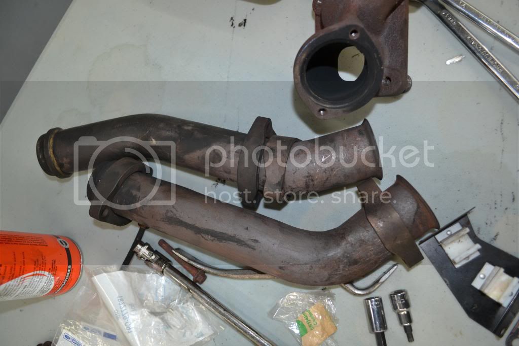

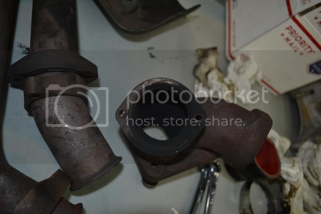

I tried new OEM donuts...they leaked, tried the Beans brass donuts...they leaked. Int'l has bellowed up-pipes for the OBS in the price range of $900. Int'l part# 1843486C92. Bar None Diesel makes a copy of the Int'l pipes but they are out of stock. http://www.barnonediesel.com/index.php?route=product/product&product_id=30
Junk
Irate one-piece (sold them when I went T4)

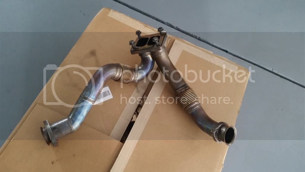

I have the riffraff ones, and they are a fantastic product! No leaks even after pulling them off and reinstalling twice with the same gaskets they came with! Id highly recommend!
I went with new riffraff
how was the install?
Being that I replace my stock gaskets every 50k....
