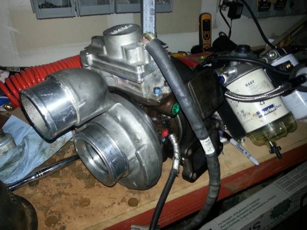

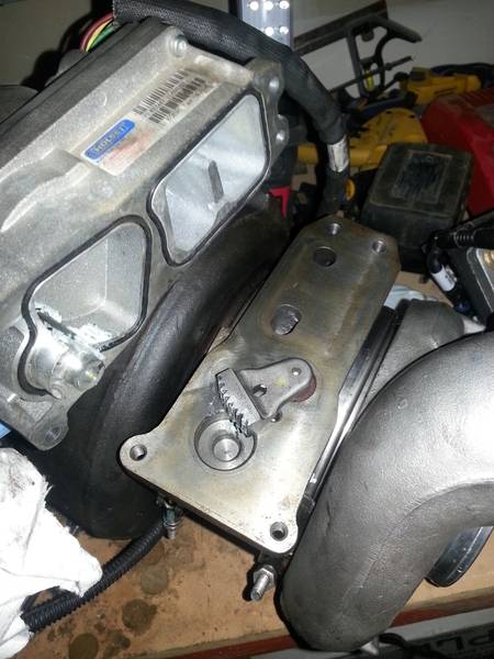

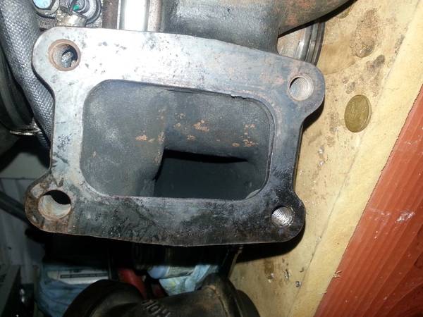

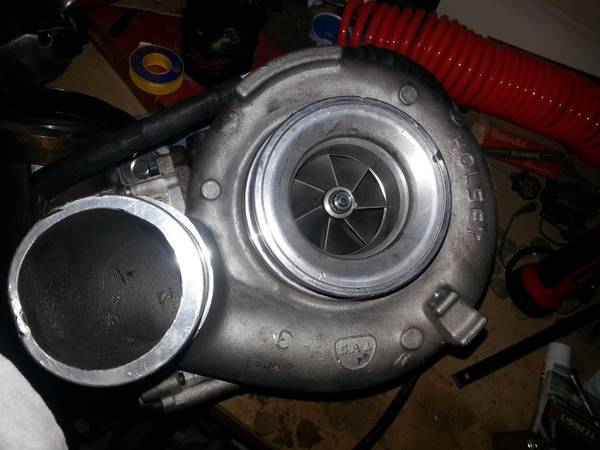

UPS man was here
well the UPS man stopped by. Wasn't packed all that great. Looks like she had a rough ride over.
superHX40 7 blade:
T4i mount
Removing the electric controls
