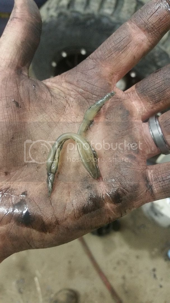

Well I just got the cooler off. The o rings don't seem bad to me. This was hanging out the end of the cooler though.

Well tried like hell to find something wrong with that oil cooler but everything looks good to me. With the way that oil looked I was pretty doubtful it was the cooler.
