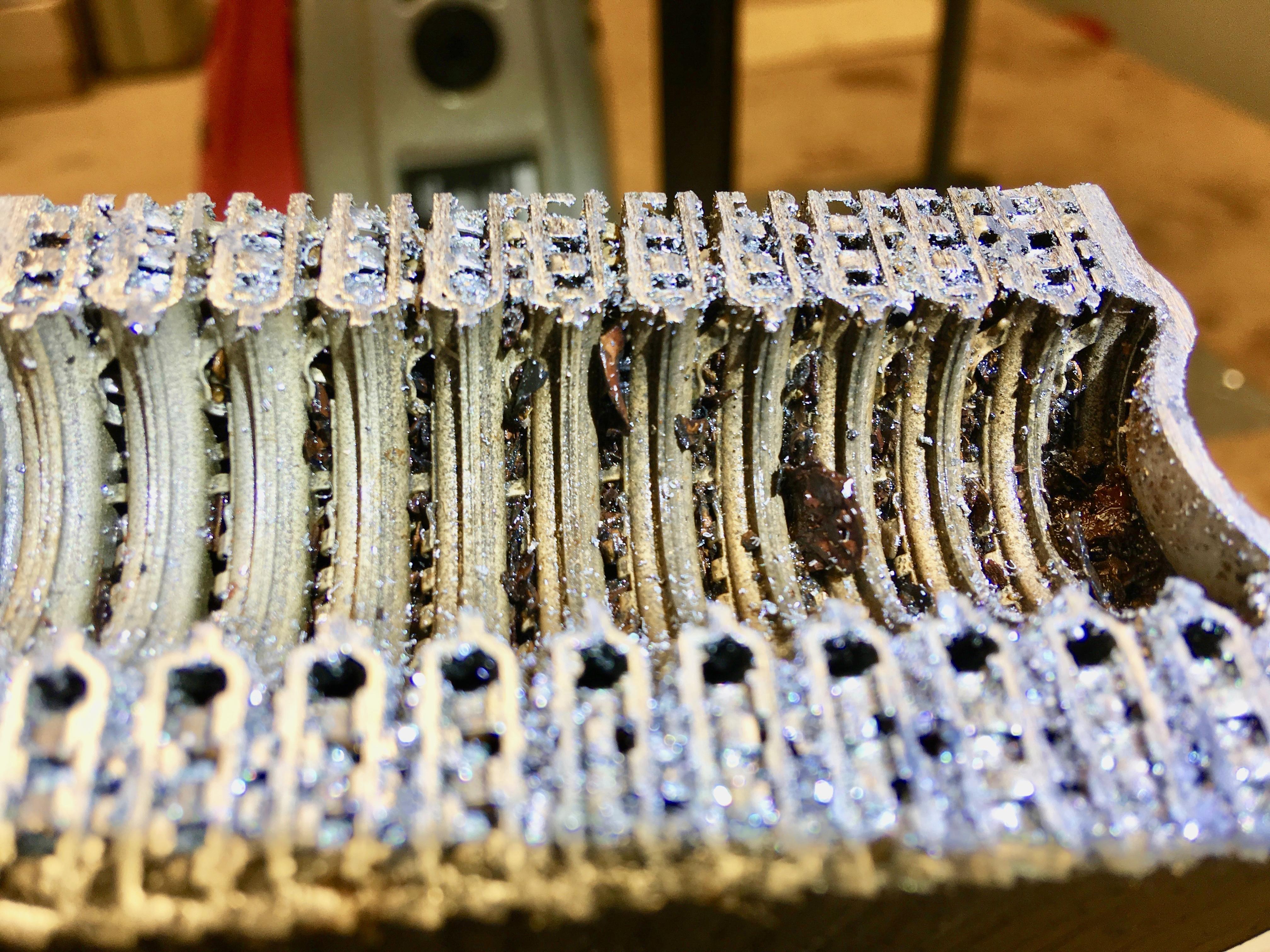

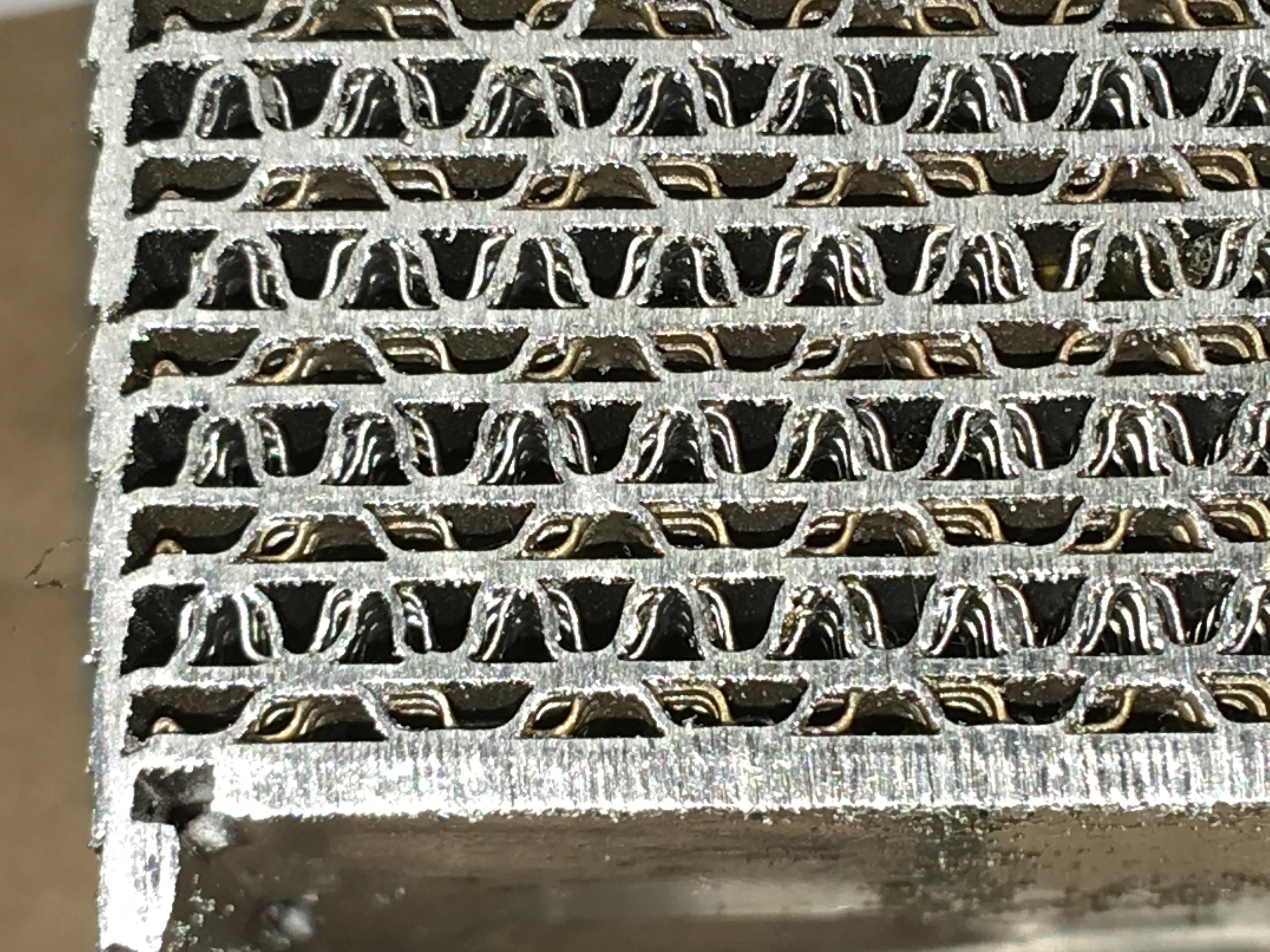

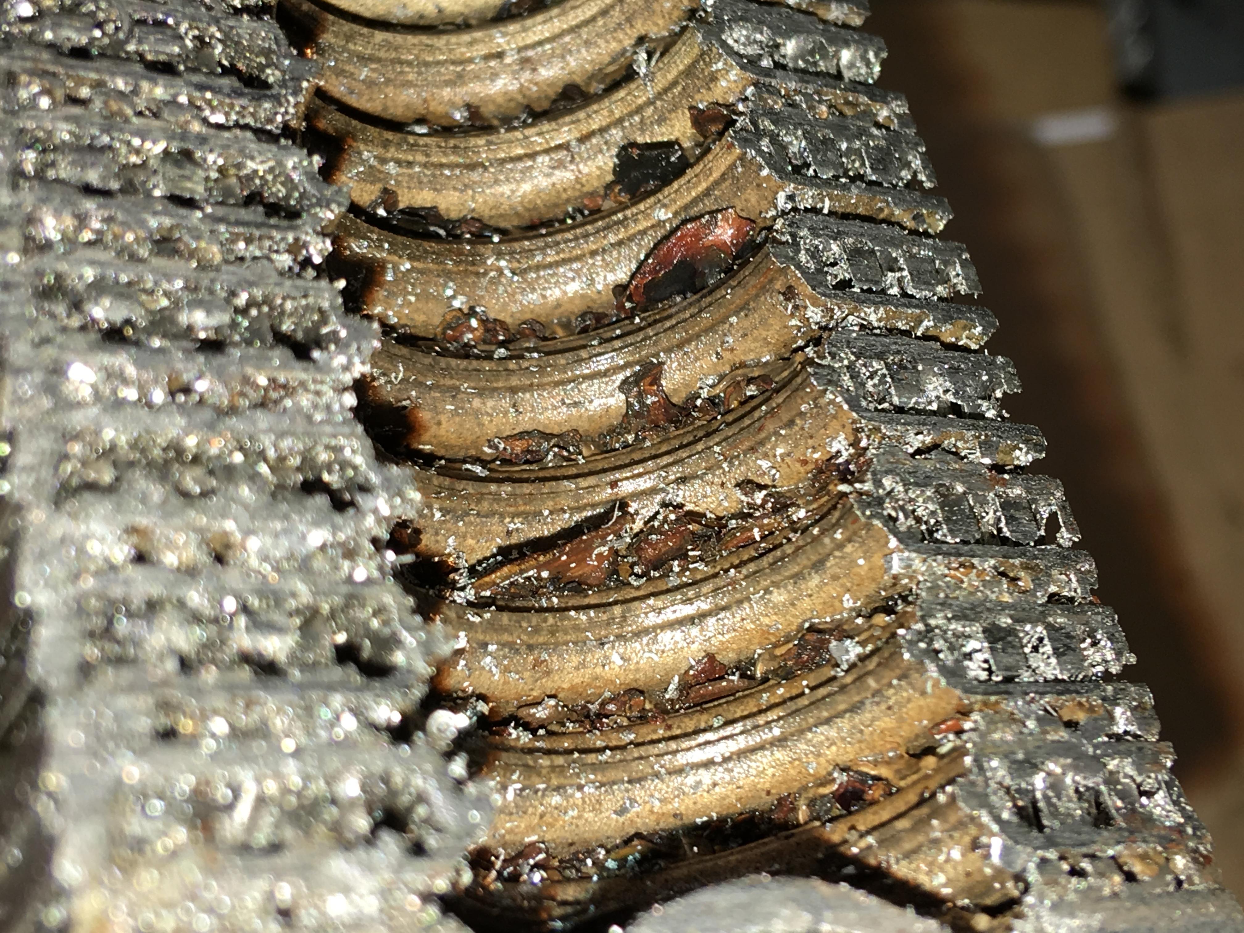

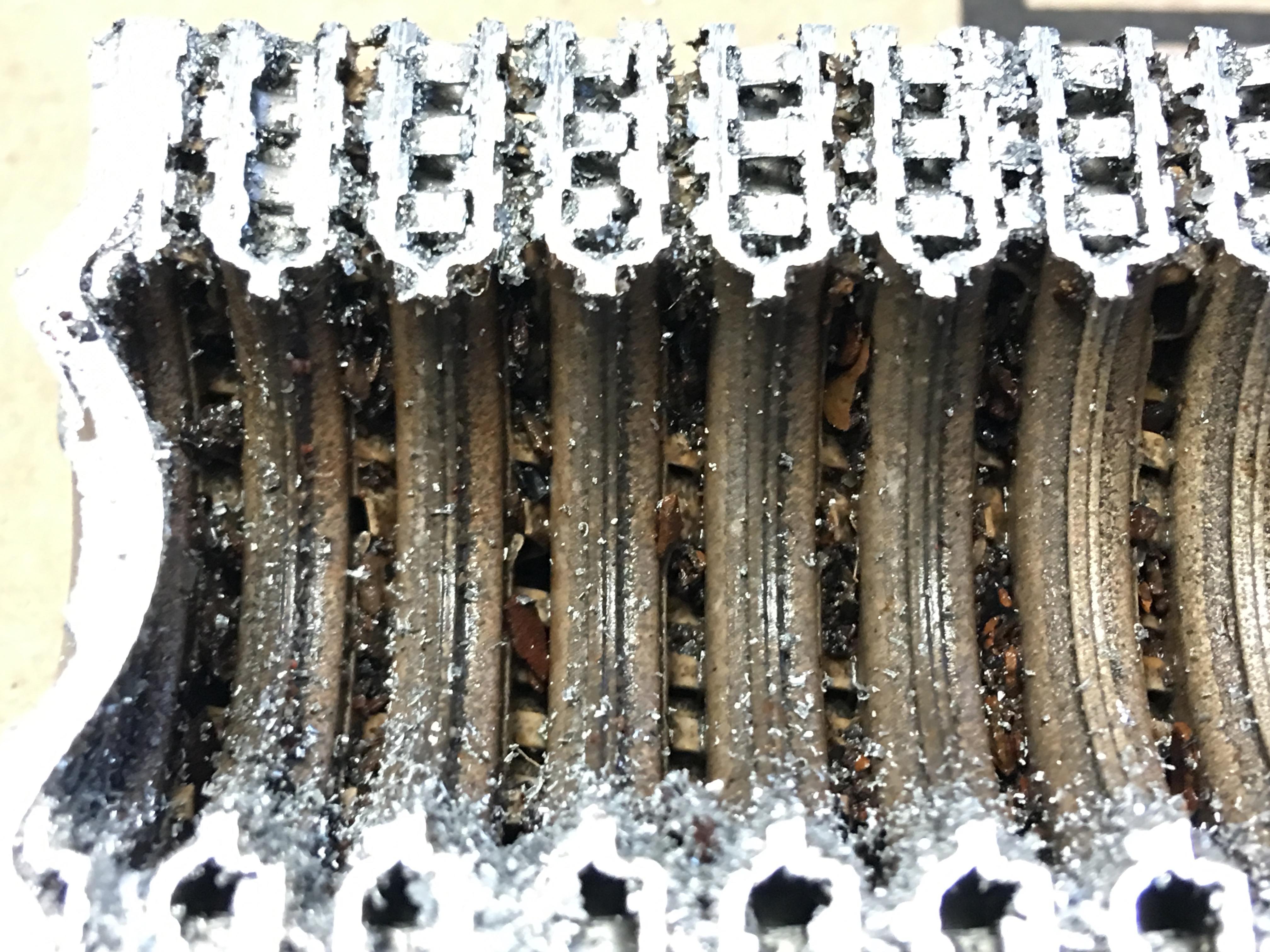

TooManyToys
Oct 23, 2018
87
Jersey Shore
No problem within the plates with ELC, but debris in the intake ports.
