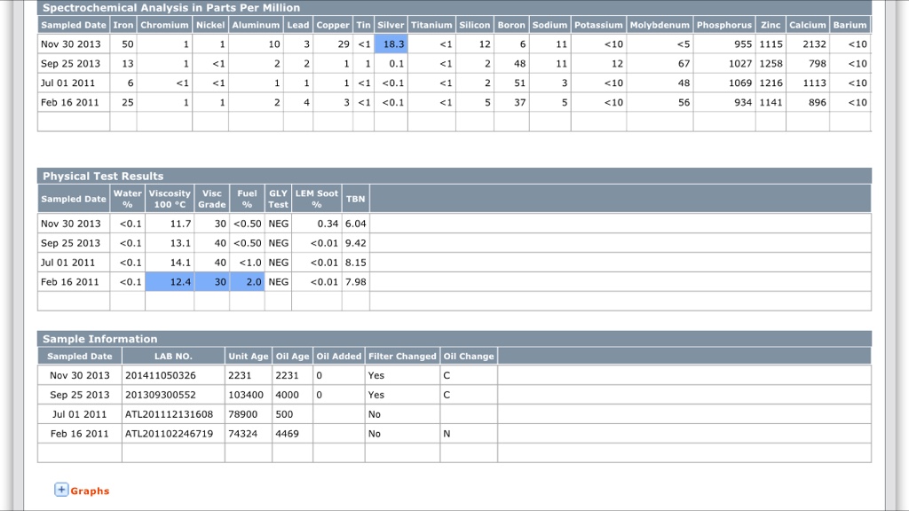

Here is a sample of two trucks.
My 2013 1st oil sample was in Nov. at 2231miles of factory oil.
The second time on the '13 was in Oct 5000 miles of amsoil 5W-40. Only 1k miles of that was deleted. At that point truck had 7200 miles when the oil was changed.
The rest was from my Deleted 2005 f250.

Thanks for posting that. Surprisingly not much in the way of fuel dilution on your second report on your 13.
