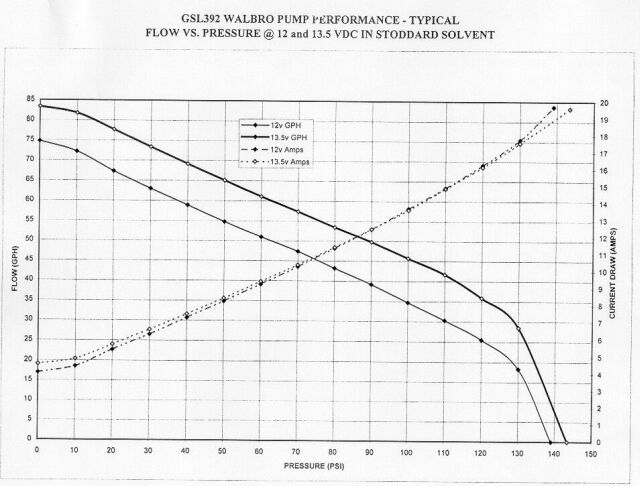

So I was doing math this morning figuring the flow of 300cc injectors at 3500rpm.
Injector flow as far as I know is based on 1000 shots.
So 300x8 is 2400cc, but since its a 4 stroke motor, at 1000rpm flow is half that at 1200cc.
At 3500rpm it would be 1200cc x 3.5 = 4200cc per minute.
4200cc per minute is 1.1gpm.
1.1gpm is 66gph.
My Walbro, according to this graph, at 62psi is around 50gph.
Looks like I need to do the dual SD pump setup.
Anyone know the flow specs on a stock pump?

Math check...
3500 rpm
1750 "shots" or injection events per cylinder per minute
8 cylinders
1750 "shots" or injection events times 8 cylinders equals=
14000 "shots" or injection events for the motor over one minute
Since 7.3 injector capacity is rated as number of CCs flown over 1000 shots, we need to divide the number of shots (in this case 14000) by 1000. This equals 14.
14 times 300cc equals 4200cc per minute.
4200cc=1.1 gpm=66 gph
Looks good by me.
I don't know of a published spec for the stocker pump, but I believe the common thought is 30 gph. My truck had a p74221 carter on it as the stocker...it took mine just under 2 minutes to pump a gallon (as pumped out of hose connected directly to the outlet of the pump).

I'm running dual pumps with 250/200s and works great,
250's @ 3500rpm flow 55.44 gph. If 2 SD pumps flow 30gph each/60gph total, thats more than enough for your needs. Unfortunately it's about 10+gph less than what 300's flow at 3500 rpm, and I may push the rpm's to 4000.
However I do have a spare Walbro, and in theory two of those in parallel flow 100gph, which is way more than I need even at 4000rpm. Walbro's are only $110 ea for a replacement and I get the redundancy just like the SD pumps in parallel.

As for flow the walbro about equals dual SD from what I have tested. Both will handle 200% nozzle injectors running typcial PW. But here is the reason duals are better even beyond the redundancy. A single pump has to use more volts an amp thru its pump than a each of the SD. That means that much more eroding of the brushes etc. Two smaller pumps are running lower power each but together equal the single should have less wear and last longer. I think this also is clearly shown with the track record of these pumps and setups. We know the bosch SD have a great track record and the reason is they are not asked to do both high volume and pressure just high pressure with moderate at best volume (25-28 gph)
