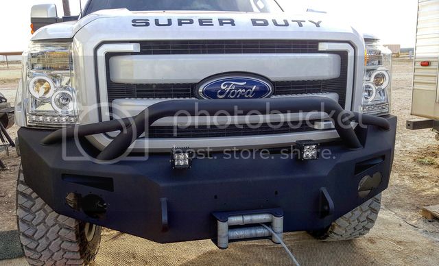

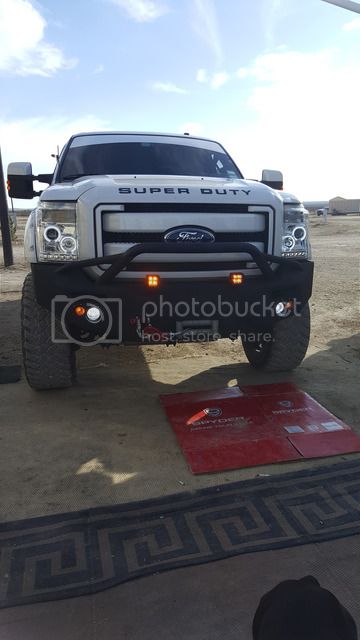

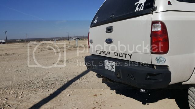

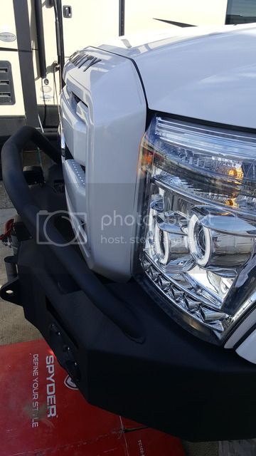

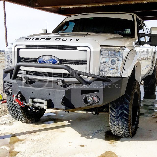

I bought the Truck used 3.5 years ago with a majority of the upgrades already done. I removed all the old HID wiring, etc... and replaced it with LED bulbs. I've had an issue with the driver side front blinker not blinking. Ford is aware of the issue and says it's BCM related. I've had it reset before and it worked for awhile, but the problem showed up again a few months ago. Hopefully after this next reset, the BCM will be happy without all the extra wiring, HID's, etc...

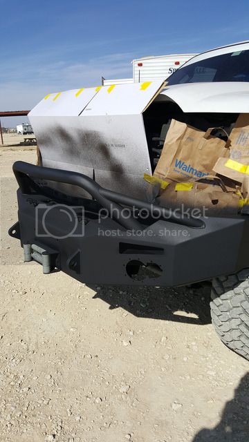

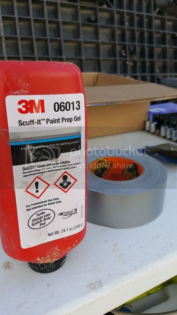

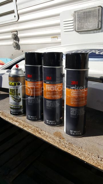

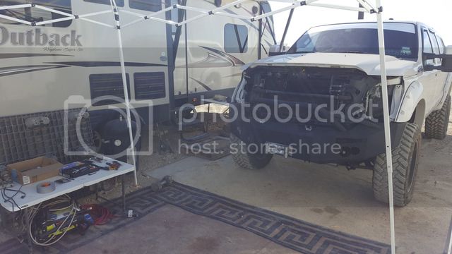

While upgrading all the lighting I decided to clean all the rust and damage on the Fab Fours bumpers and coat them with some quality undercoating. Painting is all in the prep, but it was a challenge seeing as I'm in the West Texas oil patch and it's basically a desert. I had to wait for the right weather to tackle this project.
New Parts:

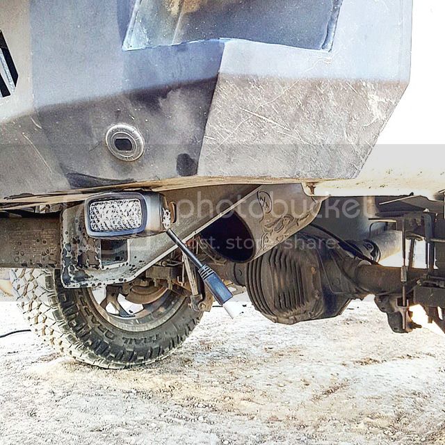

- Rigid amber fog lights
- Rigid reverse lights
- New Fab Fours marker lights and fog lights
- LED bulbs all around
- Spyder projector headlights
- paint and prep supplies

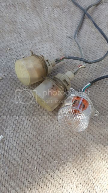

Old Setup:

I figured out that having the blinkers on while installing new lights is crucial, along with marker lights. I wired in 4 resistors on all corners. All problems fixed!
