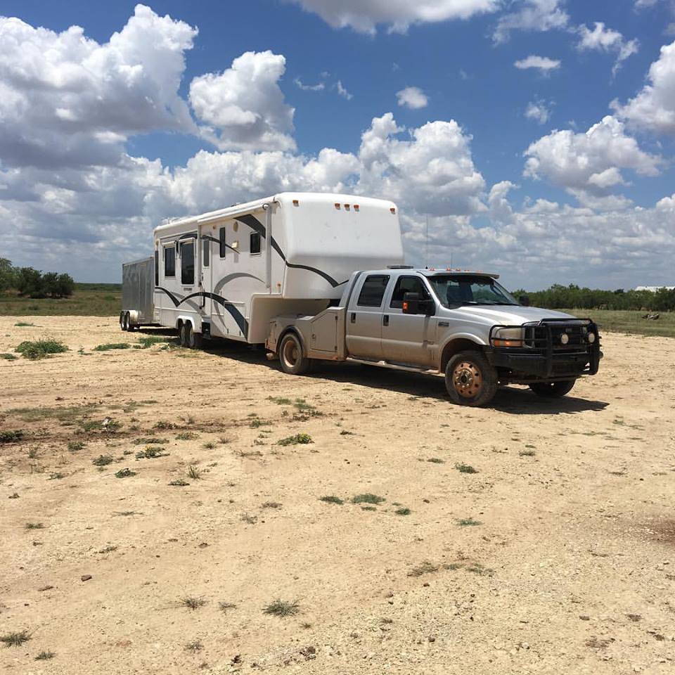

Hook on to this and im sure she will warm up a little. im guessing that we are north of 30k. If the budget allowed it id have a 6.7 and dump this turd lol.
LOL fair enough, definitely would get nice and toasty . 6.7s pull very nice, let me know about the 6.0 snow fan clutch
