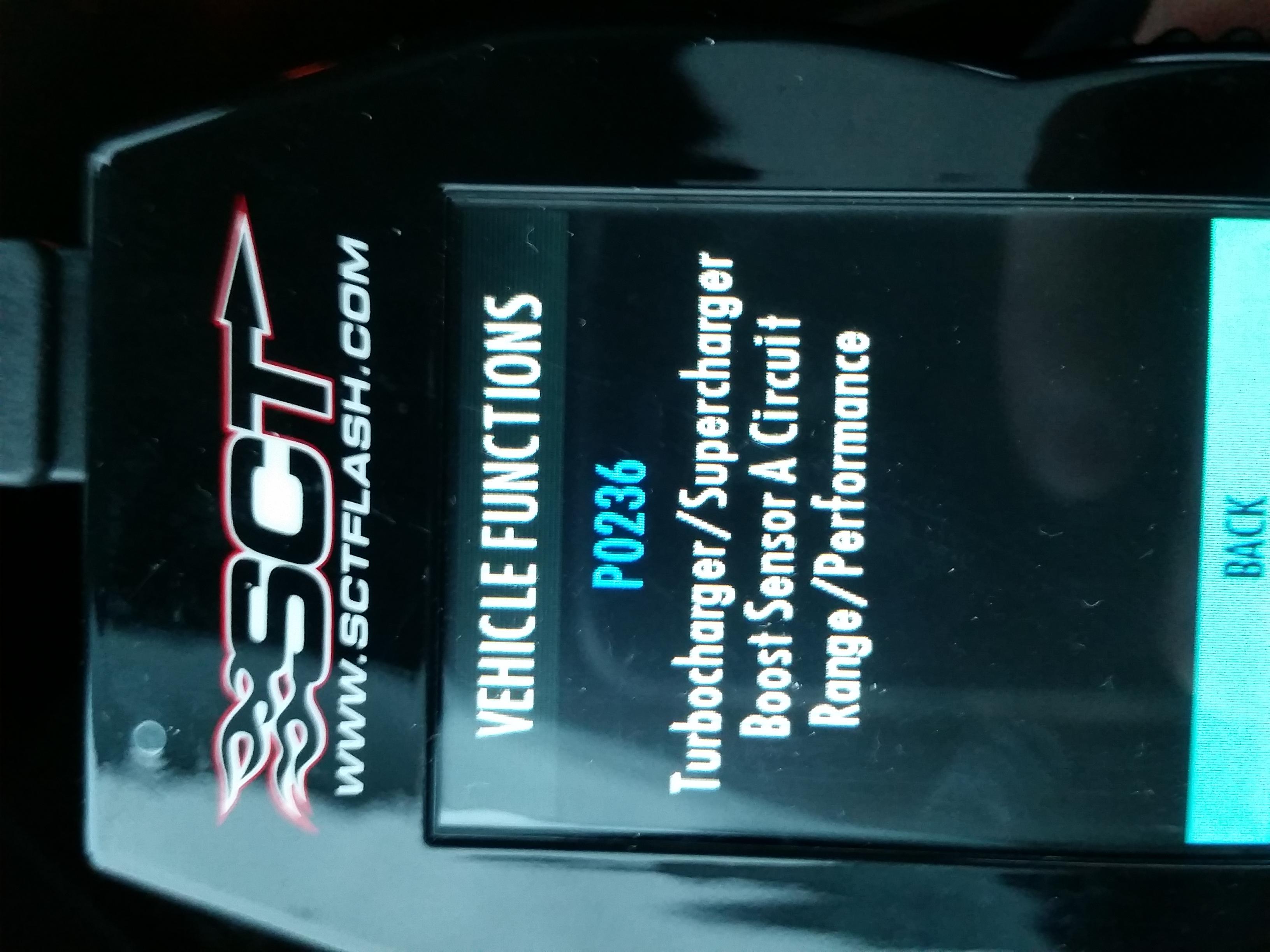

Hey guys running delete tunes and Morgan's 64mm street max turbo. Whenever I get into the throttle the truck throws This code I unplugged The map sensor and plugged it back in and same issue. Any thoughts or suggestions

Are your tunes specifically crafted for the 64mm turbo? You might be overboosting as far as the computer is concerned and that's why it's throwing that code.
I'd contact Morgan and see what he has to say.

I haven't had it happen on my 15' with the v6 pip tunes.Ive only ran the tow and performance tunes but I've beat the snot out of it so far!!

so im just wondering if anyone is running into this issue with their race files, eric has rewritten me the tune a couple various ways and im still getting this code. i loaded the tow file and had no issue with that one.
