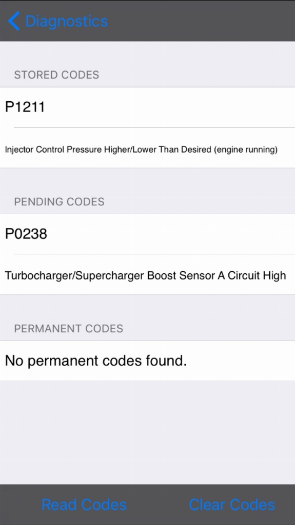

Diesel newbie here.
I got these codes on my 7.3 Excursion. After research I see that these are codes due to over pressure from a tune.
I do have a TS-P 6 position chip.
I guess I will clear them out and see if they come back. Any way to avoid these or is there an actual problem?
I was pulling my boat just cruising at 2k rpm. Not being hard at all. So?
It has 256k miles on it and I'm pretty sure HPOP is original.
Also my wasgate is making chirping sound right at the 3rd-4th shift as well as accelerating in Overdrive. Maybe this is the culprit.
Sorry for the book.
If anyone can offer advice it would be greatly appreciated.

Codes cleared and rolling along fine so far. Now to figure out waste gate chirp.

Tony does not stop the overboost codes, it is a soft code, the light will go out after a few minutes of driving at under 25 lbs. of boost. The ICP lower or higher than demanded is simply an HPOP that cannot keep up with demand. Same thing, if you stop demanding high ICP for a few miles, the light will go out.
