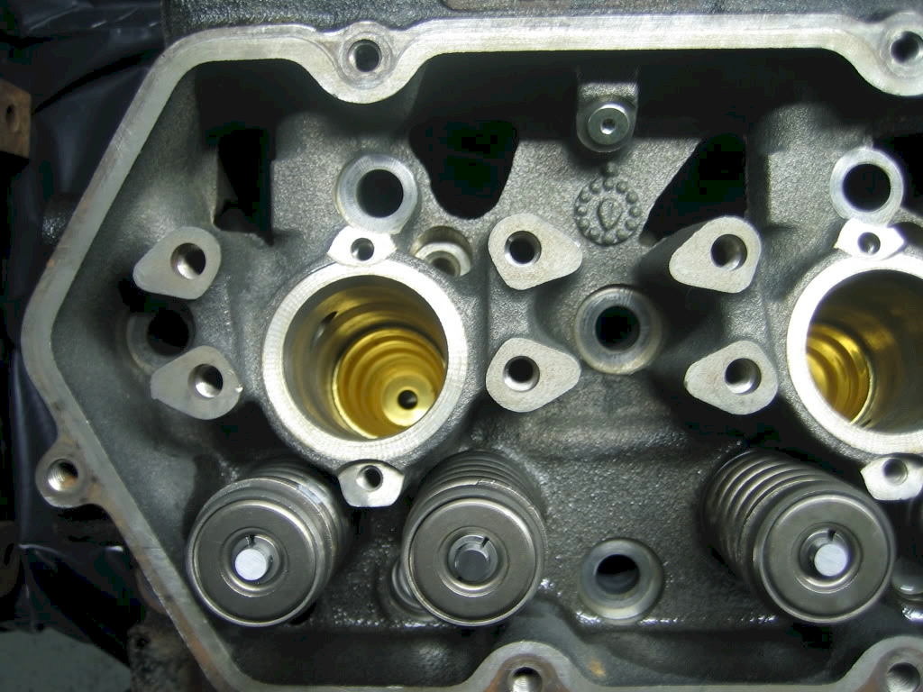

21 seconds seems a bit fast to be leaking down. A couple suggestions...
First, check the pressure with the V/C off. There are small cap-bolt along the top of the head (see top of photo, right above the casting stamp) which can leak. Also, check to see if any bubbles or fluid is leaking from around the injector bores. Finally, check and see if any oil is weeping from the discharge nozzles on the back of the injector. (You'll need a flashlight and an inspection mirror to get a good look. The ONLY place you will not be able to verify will be the oring between the oil rail and fuel rail. However, this can be checked by looking for oil contamination of the fuel. This would be especially noticeable with a low tank since the fuel would be more diluted by the oil.
I hope this is helpful.
