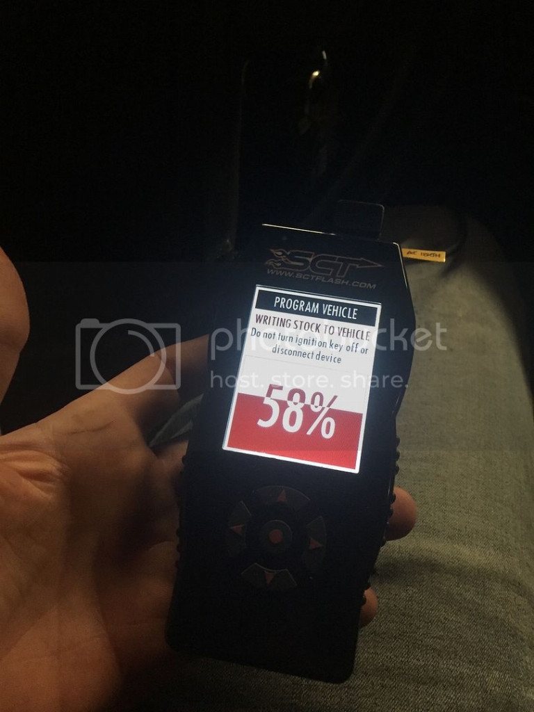

Well I've been driving in GH tunes for 2 weeks now and drove the truck around today after getting the updated files loaded up. Drove into town and checked codes and still have the p2073&p2074 on the code screen but NO CEL.....yet.
Aug 2, 2011
934
Central Illinois
Drove be truck today. Everything is fine and no codes and no cel. Dropped the wife off at pharmacy and went and parked and idled for 5 min. Looked down and I have the cel on and the 2073 & 2074 codes are back.
Am I loading these tunes completely wrong or what? I have the updated files loaded from Mike and I first loaded the the truck back to stock and then loaded the new updated street file from Mike.
Am I not supposed to be returning the truck back to stock before I load the tune back to the truck?
