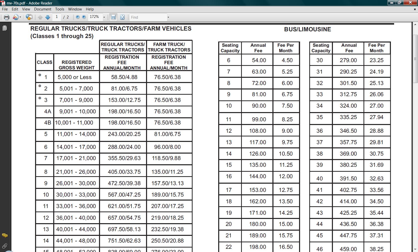

If your trailer is over 10K GVW, you need combined plates for your truck and trailer to be legal. So for example if your truck has a 8000 GVW rating and the trailer is 14000, you would need class 8 plates (21,001 - 26,000lbs) which is $405 a year. I also think that trailers over 10K have to be inspected twice a year. Some people have the GVW rating of their trailer set to 9990 to get away with it. I would consider all of this and research a bit before buying anything. I have a 14K bumper pull and have it registered at 9990. Otherwise here is the chart to use if the trailer is over 10K GVW...
