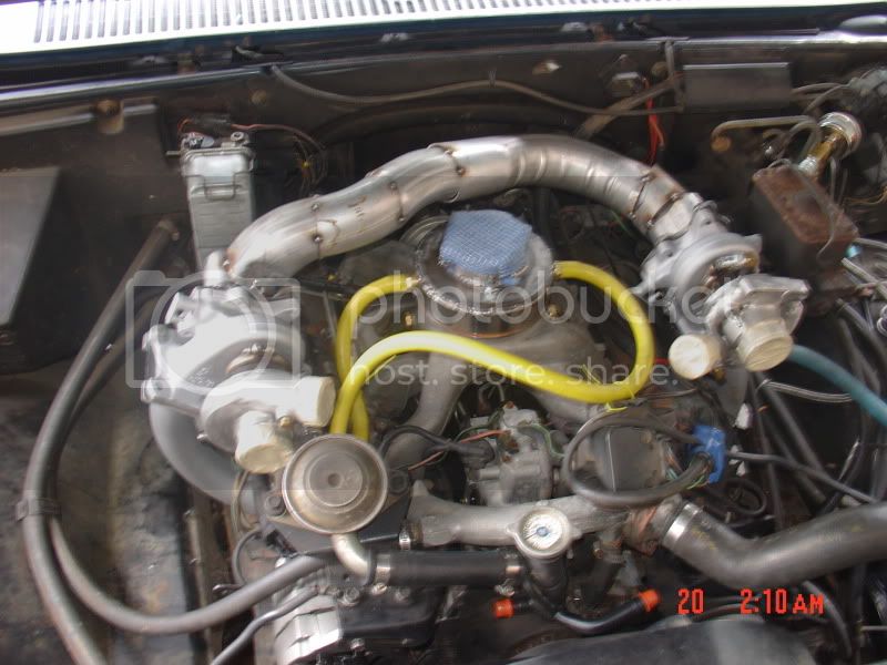

Look up member Chrisf97305. He built that truck in the video and I think it has been sold on to someone else. Very top notch fab work. It was a daily driven/drag/pull truck he said. He had a build thread on PSN. Lots of information. There were a few other parrellel twin 7.3s that were not so successful. It's a lot of work to fabricate a twin setup hope you have the fab skills. I have built a few custom turbo kits. I put twin parrellels on An old Chevy 6.2 idi farm truck years ago. The fabrication part is not all that hard it's the fact that it sucks up so much of your free time.
The old Chevy 6.2TT built with scavenged parts. I had like maybe 80$ out of my pocket on the setup.
