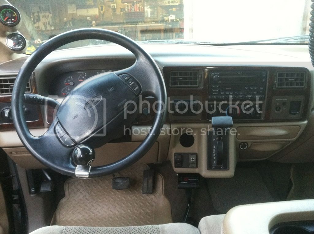

Mine is a 99.5 with a lot of 05 exterior pieces on it.
That's pretty cool, kinda like a push button Allison then. You don't NEED any of that for a 4r though.
Pretty sure you just need the column shifter from an auto truck, column plastics, and shift cable. Not sure how you would make the transmission position on the dash work though since it's digital like Frank mentioned.
Here's my shifter
