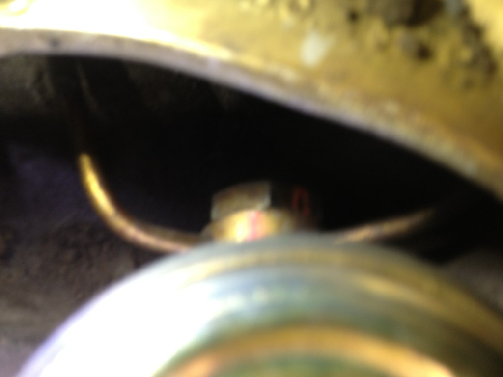

Encountered another problem! The banjo bolt won't line up with the lines! Is it because of the crush gaskets? Or should I back it out and try again? Here are some pictures of my dilemma. Any & all help is appreciated. Thank you.
ImageUploadedByTapatalk 21373510438.627602.jpgImageUploadedByTapatalk 21373510449.146677.jpg
The bolt is really hard to turn at this point. It sucks being so close yet so far away :( should I just give it one last good turn or back it completely out & rethread it? I have both gaskets on there (one on bolt side, one on line side against pump).

Don't worry about "holes" lining up. Fuel goes through middle of bolt and small diameter portion of bolt and puts fuel into banjo.
