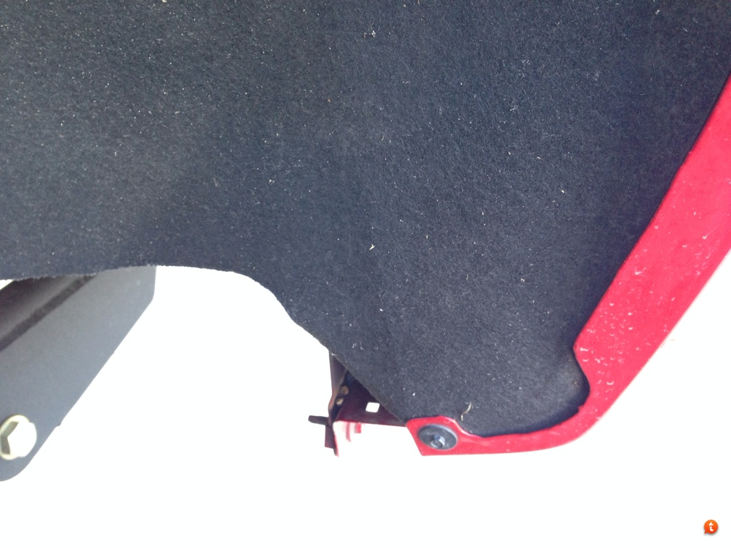

Awesome! So which shocks did you go with? How is the ride? Also can you post a pic of the trimming you did to fender liner? Which tires did you go with? Thanks!

This is a pic of the piece I apparently just bent backwards and forgot to cut. This is the drivers side, and the passenger side has even less bent up. Down at the bottom where you can see the inside of the sheet metal is where it is.
It should also be noted that I'm running 3.5 in the front. I'm not sure if it will make a significant difference in clearance though.
