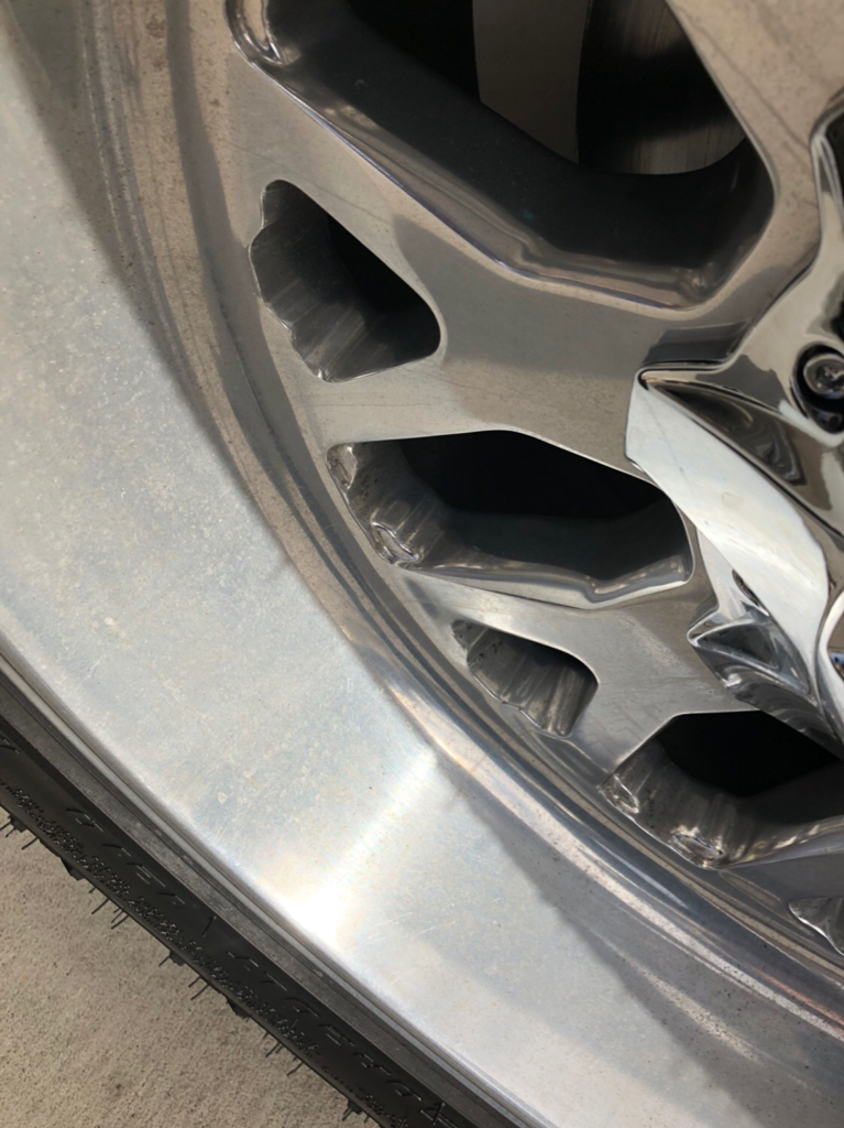

So I’ve let my wheels go a little long and they look like chit.

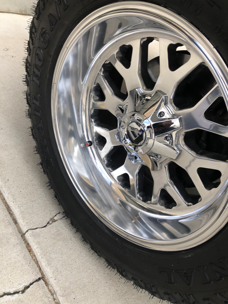

Started polishing today. About an hr with a mother’s cone and polish I got the one I did today looking a lot better. But still isn’t perfect.
What tips/tricks y’all got? I feel like there’s gotta be an easier way.
Before
After
mandkole
Jan 14, 2012
2,305
Northwest
They look good. I use the power cone as well. I sometimes use some 1500-2000 wet paper to smooth the surface to allow quicker cleaning. I do my 8 spoke 20s twice a year and it takes about 30-40 mins per wheel.
