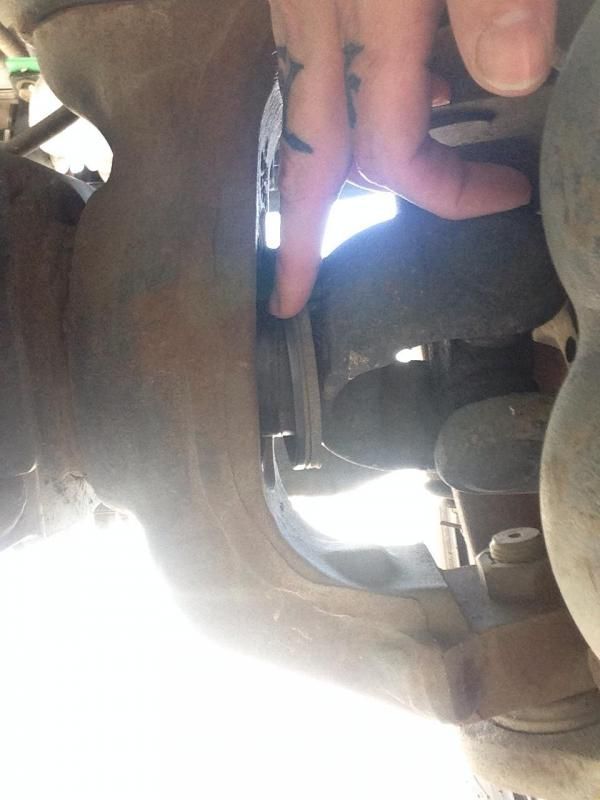

Popping noise front right tire area

The ring is the dust seal, they are known to come off. Wont really matter unless you are driving where it is fully submerged in water.
Popping with the lift....Id check the trac bar first and make sure its torqued to spec. Usually its not bc the spec is so high, 400 ft lbs iirc on the drivers side.
Ball joints - check them and find out. Jack it up, put jack stands under the axle and rest the truck on the stands. Grab the tire. You are looking for side to side or up and down movement.
