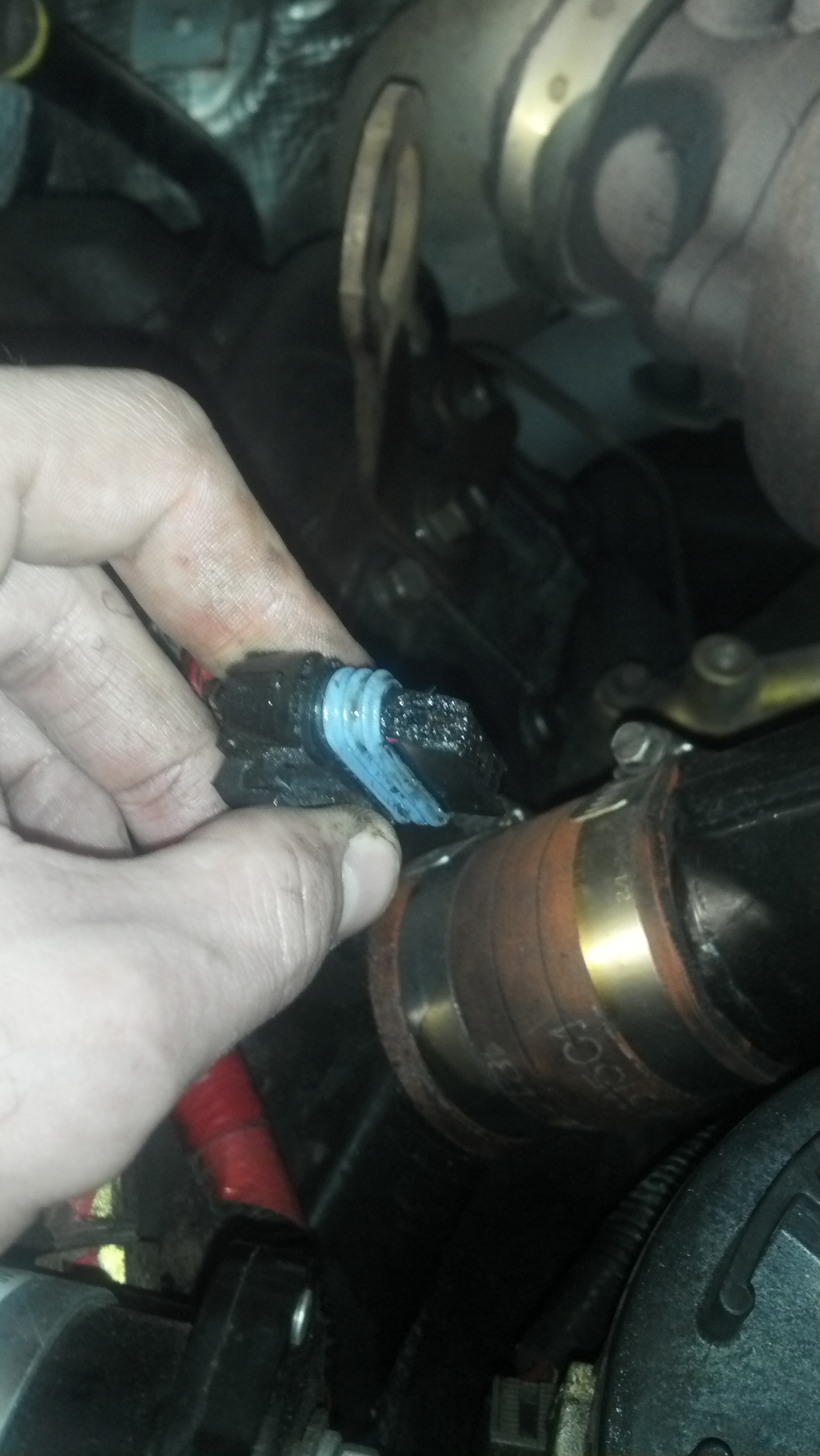

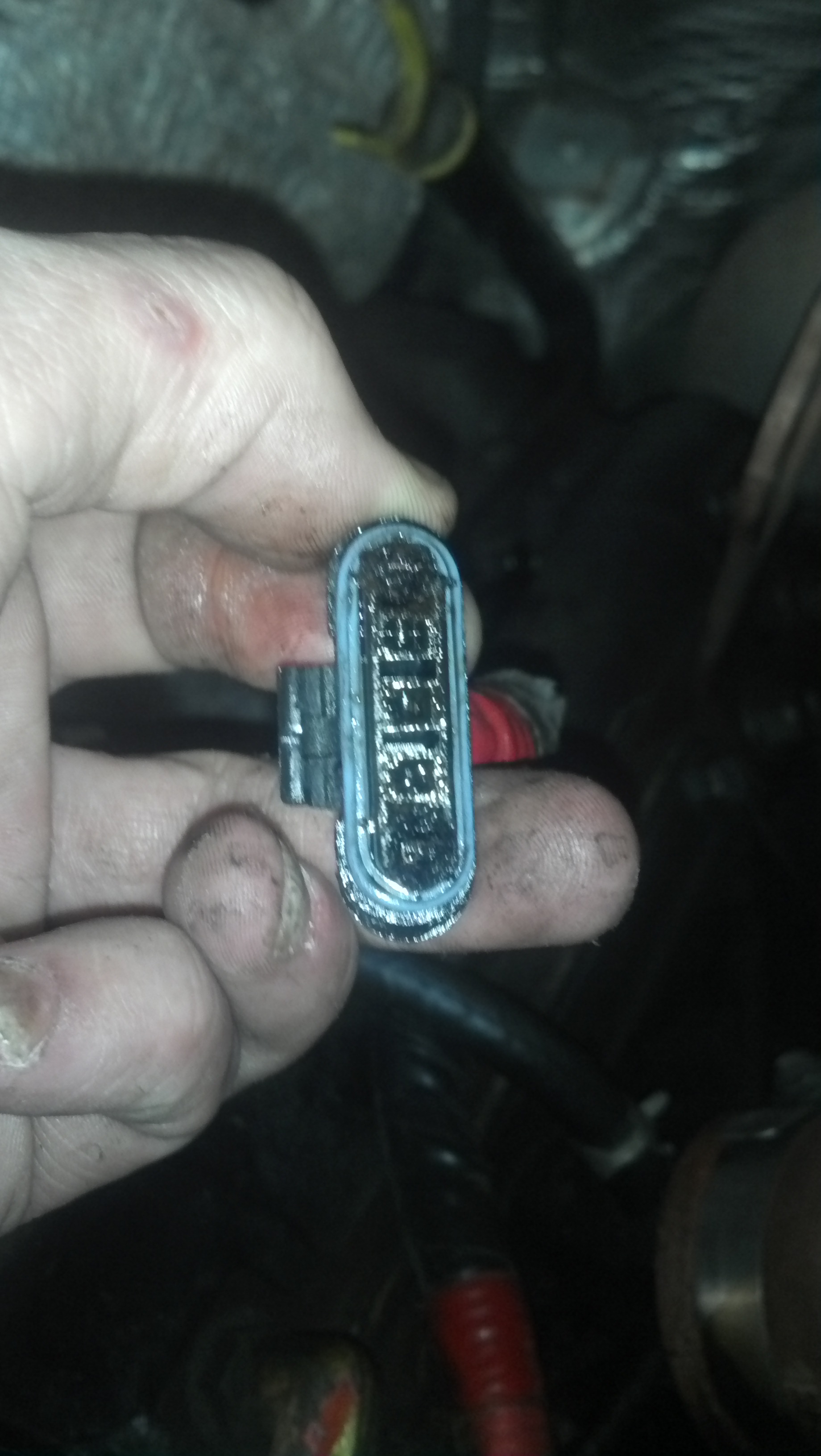

Well ... that back fired. I took out the shrader valve tonight and tested the fuel pressure again. Same thing ... was right around 11 psi. Just for the hell of it I decided to check the resistance in my glow plugs too. They all checked fine, but one of the plugs (back passenger side) broke when I pulled it out. The plastic on the plug and the outside pins broke off of it. I have attached some pictures that are hard to see.
With that said, is there a repair bundle for these plugs or would I be able to have the dealer re-do that plug for me? I dont think it hurt the UVCH. I dont have the weather pak (or whatever this particular style is called) of tools to fix it.
After that I couldn't get the truck to start. I dont know if that is from the glow plugs not working on that one anymore, or if the plug messed something else up even more.
Thoughts?

Tom S
Moderator
May 20, 2011
3,365
That is repariable for sure. Here are some part numbers to get you started.
Valve Cover Harness Repair Kits (contains 4 hard shells w/seals, w/o terminals)
(Ford) F7TZ-14489-BA (94-96)
(Ford) F7TZ-14489-AA (97)
(International) 1830829C91 removal tool and Shells w/o pins
(International) 1661875C1 Pins
(International) 2501055C1 Pins with 6" wire
Valve Cover Pigtails with plug and wires, OBS
(Performance Specialties) 99288
kampy
155
Rio Rancho NM
Another option if you have a diesel repair shop anywhere close...most times they will have the pigtails for sale, all you have to do is cut the old one off and solder the new ones in place. I think NAPA has them as well.
