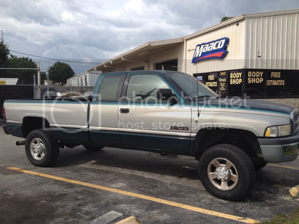

I picked this truck up today for 5k (will need any bodys input I am new to cummins)
Truck: 95 2500 eclb P-pump 12v came with 100hp injectors, built tranny, and a bunch of pennys and trash
Goal: build a 1000rwhp drag truck
Cosmetic:
- Paint Gun Metal Mono chromatic (picked up the truck and took it straight to maccos)
- Interior seats headliner and carpet black (going straight to my interior guy one it is picked up from paint)
- new tires (new nittos sitting in the shop ready to go on)
- all new lights ordered
- cage
Engine plan:
- motor is coming out
- billet push rods
- valve springs, billet retainers & keepers
- cam
- P&P head
- balanced bottom end
- pistons (not sure which ones)
- 4kgsk
- Fire ring head
- i know i am missing stuff open to all suggestions
Fuel:
- pump will be sent out to Sheid
- injectors (havent Decided)
- airdog 150 for the LP system
Air:
- twin kit built by me
- Billet s364/s480
- S.S manifold built by me
- Nitrous
Drivetrain:
- fully built tranny with manual VB
- one piece drive shaft
- Dana 80
Cosmetic:
- cage
Engine plan:
- billet push rods
- cam
- P&P head(This makes a HUGE difference in a 12v, I've heard figures tossed around of a 25% flow change)
- balanced bottom end (You're gonna love this! I couldn't believe the difference it made in mine)
- 4kgsk (5k)
- Fire ring head
Fuel:
- pump will be sent out to Sheid(Is price not a concern? They do great work, but you will pay)
- airdog 150 for the LP system(Check out mechanical lift pumps)
Air:
- Billet s364/s480(Personally I'd look into a HE351-S362-S363/68 over a S483-88)
- Nitrous
Drivetrain:
- Dana 80
Just tossing a few ideas out there.
