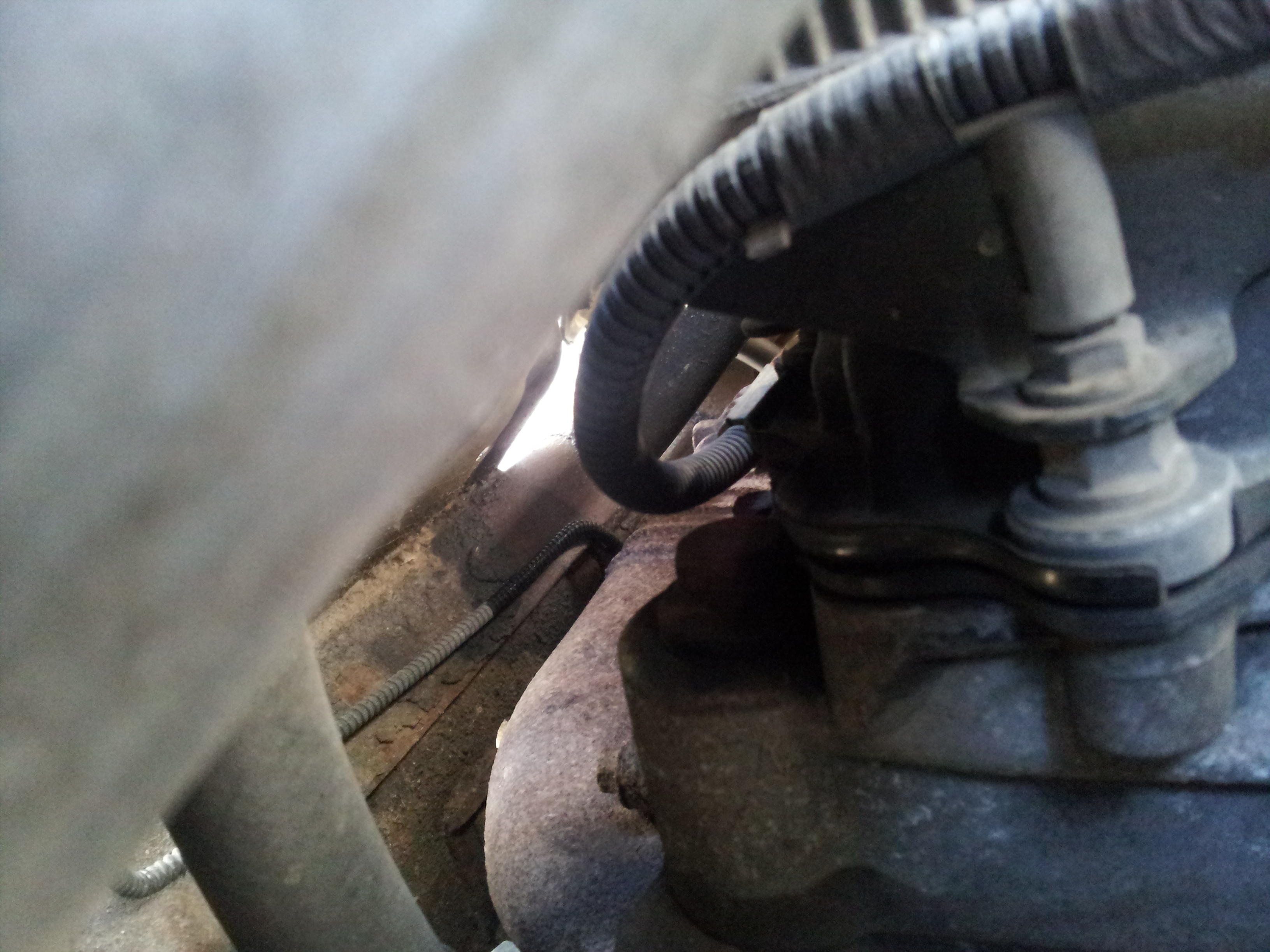

Here are some pics. I want to get some stock 20s for this thing. I also need some inner fender liners. Any body have some they'd be willing to part with? I also attached a pic of the passanger side head to see if there was studs. That is a cylinder bolt isn't it? I guess I need to be ordering some studs.

Big thinkg with doing them one at a time is it is very common for the exaust seats to crack on the heads.

Ugh, I really wanted to avoid studs. The whole reason I bought the truck is because they where supposed to be done. Then a buddy of mine pointed out you can tell just by looking. I was pissed to say the least. It seems 50/50 on people saying one at a time will and won't work. Whats the part list needed to remove the heads and do them besides studs and gaskets?

Doing some looking and the lower corner tab of the current headgaskets are black. That would be the infamous Black Onyx Gaskets, correct?
