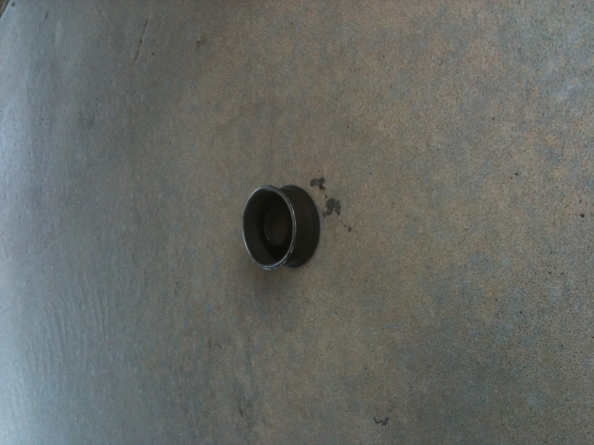

its the ribbed one under the alternator.
I just got done shopping, and can get the tensioner, 2 idle pulleys, belt for 109.00 plus tax pick up in store, saving 40 bucks!!!!
here it is where it fell off, just thank god it was in the driveway, cause last nite I was 40 miles away from home at 11pm, that would have sucked

fixed it tonite, new belt, all new tensioners/idler pulleys. Now I guess I'll have to wait till next weekend on the injector orings. damn, I was really looking forward to seeing what was in there.

Chris, FWIW, it looks to me like the bearing in that pulley just flat crapped the bed.

yes, the bearing was on the bolt and toast, but the hole looked less than desireable for replacing the bearing only, I trashed that one, but saved the others since they were still good, JUST IN CASE!! I'll add those to the attic collection of 7.3 parts of just in case, lol
