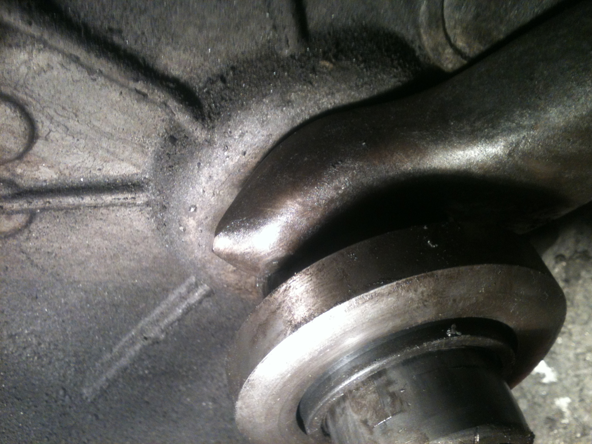

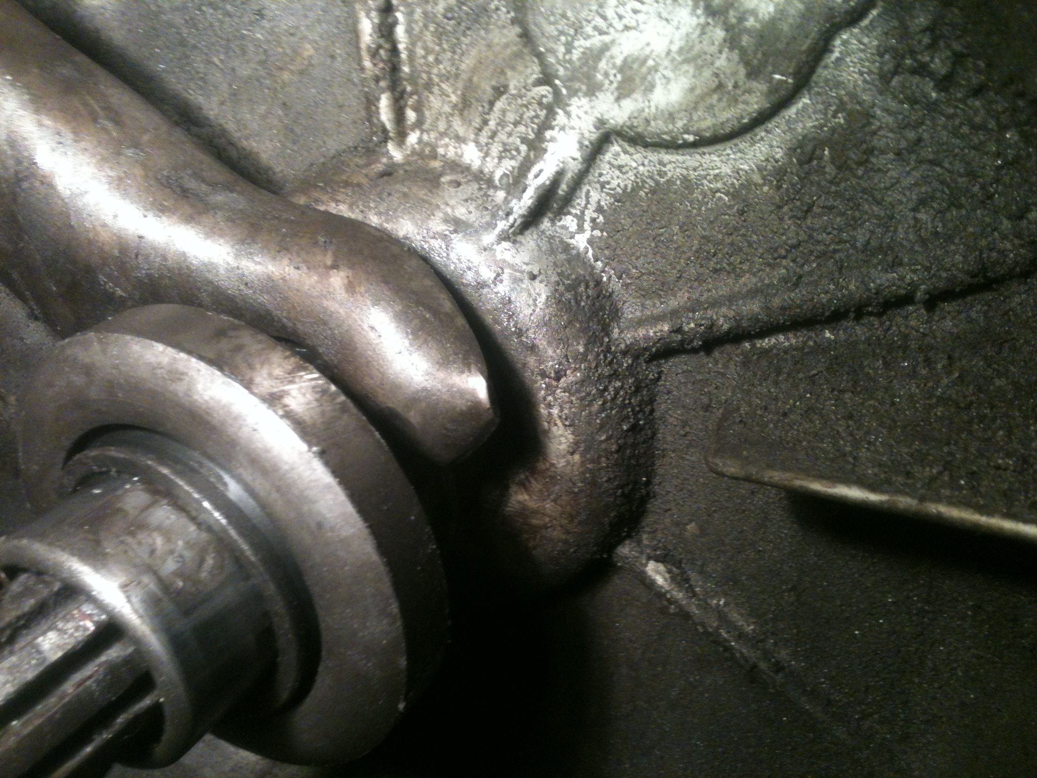

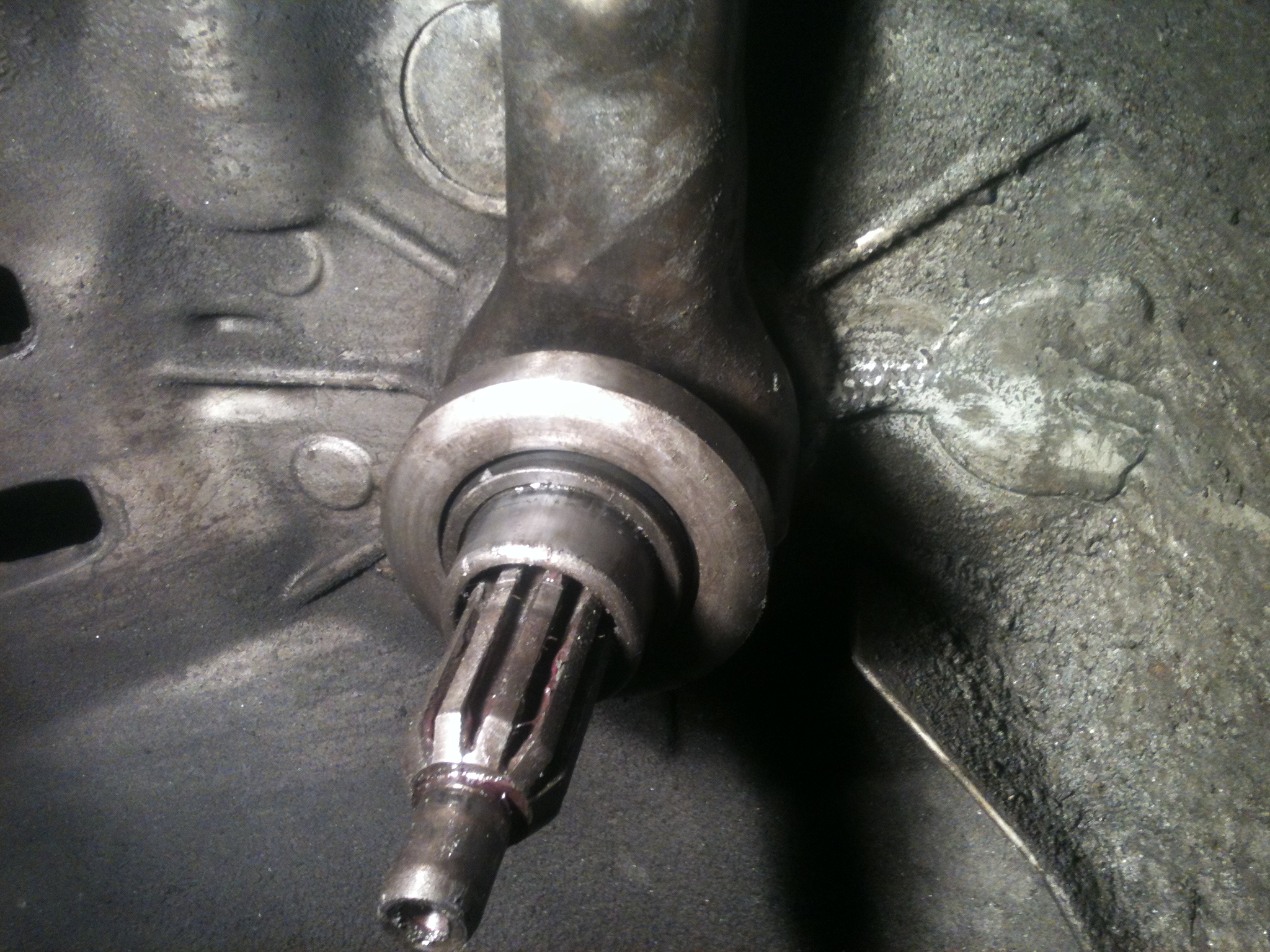

Ok guys. I need some assistance. When pulling the old throwout bearing like a jackass i didnt pay much attention! Do these pics look right?

Yes.
Make sure fork tabs are in the button on back side.
Also the guide bearing rides on, make sure it's clean as well. Old crud on it can make it sticky.
Cr500
Dec 6, 2012
116
The bearing is notched, so you can only install fork on it one way, more or less. Once you have the bearing/ fork installed grab bearing and slide it back and forth on snout. It should be nice and smooth.
