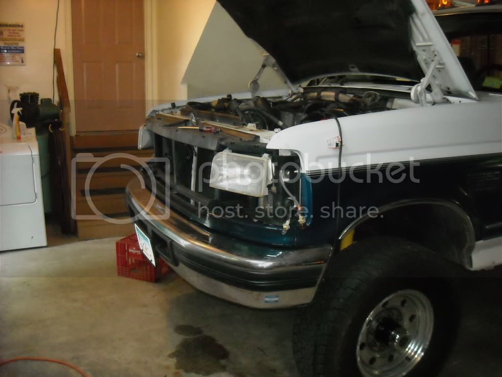

take off the grill 4 screws on top and one under the ford oval.- take out the marker light bezels 2 screws on top and 2 11mm bolts behind the marker light. if you have big arms like me you will want to take the batteries out first
it will look like this

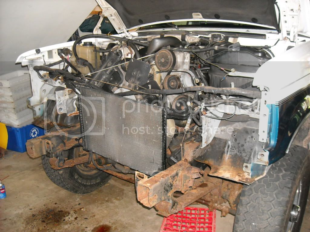

then remove the radiator three bolts on each side and the hoses. this isnt necessary but i did it so i didnt damage it. if you dont make sure you support it away from the support

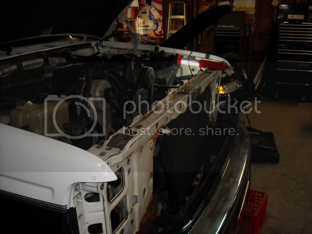

then you remove the header panel 2 bolts on each end and 2 on each side of the radiator opening and one on the valence
itll look like this

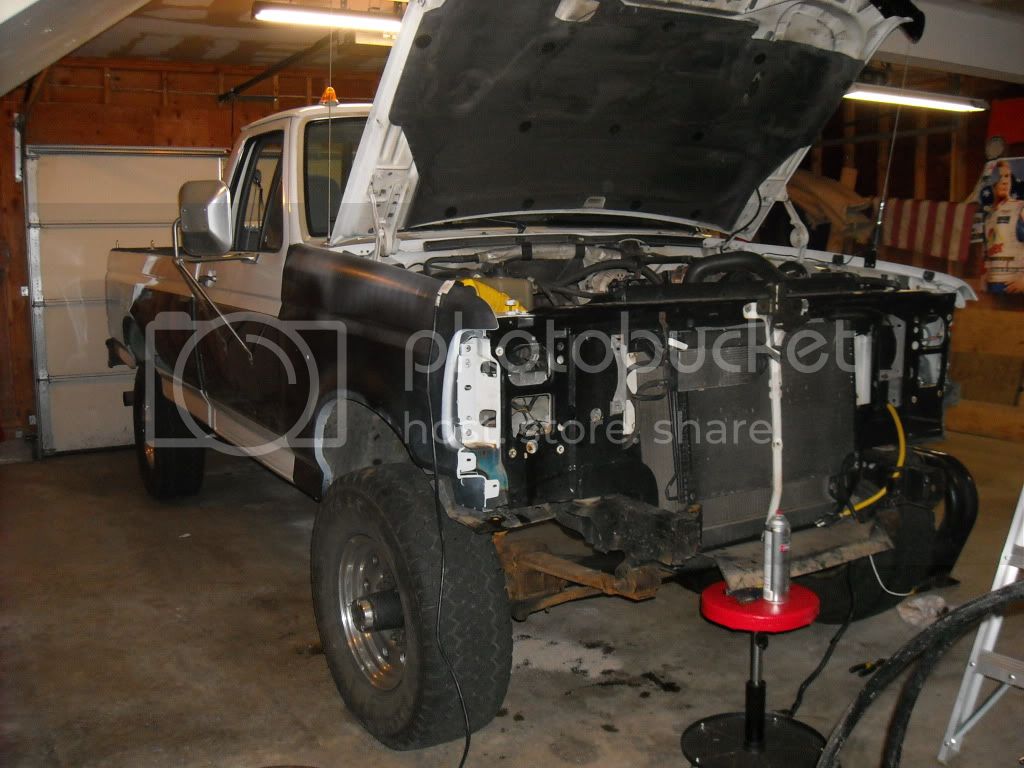

then take off the battery trays, hood latch, latch mount, horn, trans cooler, and anything else remaining attached to the support. mine was so rusted i just pulled it out but if yours isnt take the bolts off the bottom brackets i would recomend to get new mounts and bolts but its not necessary. for the new mounts you have to drill out the rivets, or cut, or chisel then replace with grade 8 hardware. the bolts and mount bushings should be replaced also mine were toasted.

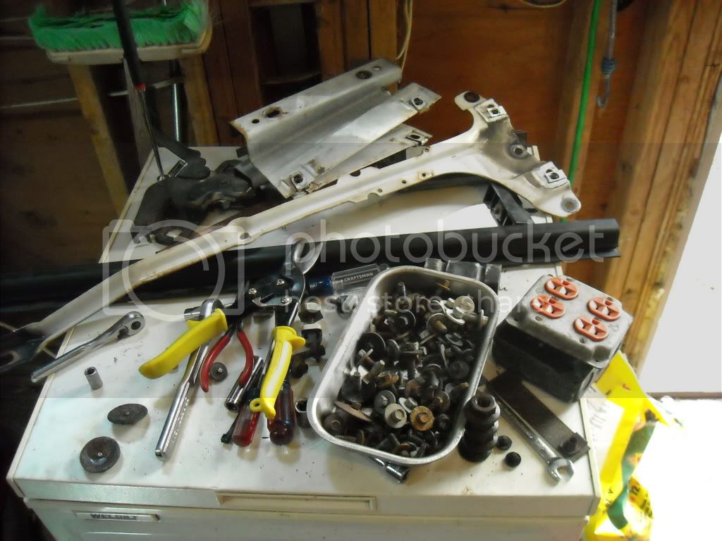

you will have a mountain of bolts do not loose track of them or your gonna be running around the garage like crazy at 11 sunday night when you have to be at work at 8 the next morning
something like this
