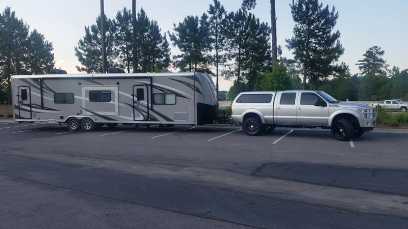

Truck in my sig, towing this albatross
Heavy, gross 25klbs.
3.55 gears, 35" tires, g3arhead tunes, NL intake.
Max speed towing is 70mph
Turbo has 65kmi on it now
First time I've noticed it being so smokey, stained the whole side of the truck on a 1000mi trip.
Seems worst in 6th, around 1600rpm and making 10-12lbs of boost. Get the revs up into the 2000s and it's clear and clean.
I don't hear any funky noises, it's making a bunch of boost (almost 30psi) when it's needed.
Towing on performance setting, but tried tow as well, about the same, just less power and downshifts earlier.
If it were a gasser, I'd say it was being lugged and was too rich.
What's the 'army's opinion on this? Am I looking at a problem somewhere (like early signs of turbo death) or do I need to contact g3earhead and have them lean out the tune in that range?
Thanks in advance.

Your under the turbo at that rpm add some gearing 4:30

I automatically lock my truck out to 5th when towing unless I'm going 80mph with a trailer haha. Keeps it from doing exactly this and loading the truck with a bunch of fuel it cant burn efficiently. That trailer is a hog so your truck is overworking in 6th and 5th gear it will be much happier

I was having pretty much the same issues as you when towing, almost same mods as well. NL intake GH tunes 3.55's I was on 37's at the time. I didn't remember the last time I cleaned my filter so I got the AFE cleaning kit and cleaned and reoiled my filter. It took about a week I think for the filter oil to really set in and work just right but after that week the smoke problem cleared up and acted just like it used to. Light haze some times. I know what you feel like though I felt like I was driving a 12v cummins with a flat bill hat when I had my GN behind me. Looked back and black smoke, I felt like a jackass
