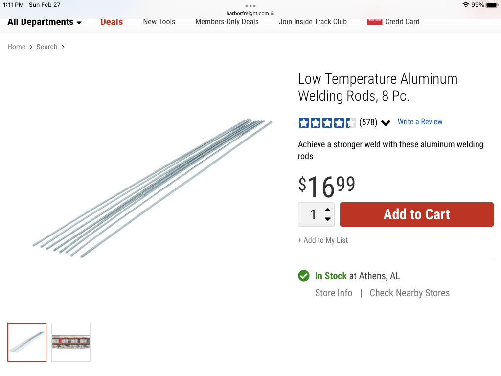

You could also braze it.

These work surprisingly well.
