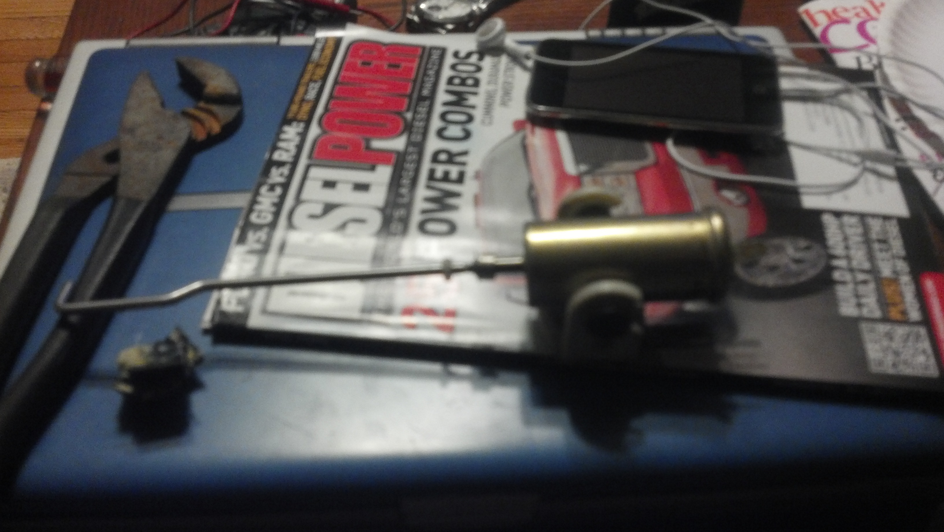

Here is a picture of the actuator cylinder (maybe not, haven't ever done it from my phone) .... pliers didn't work, now there is some missing plastic, no biggie.

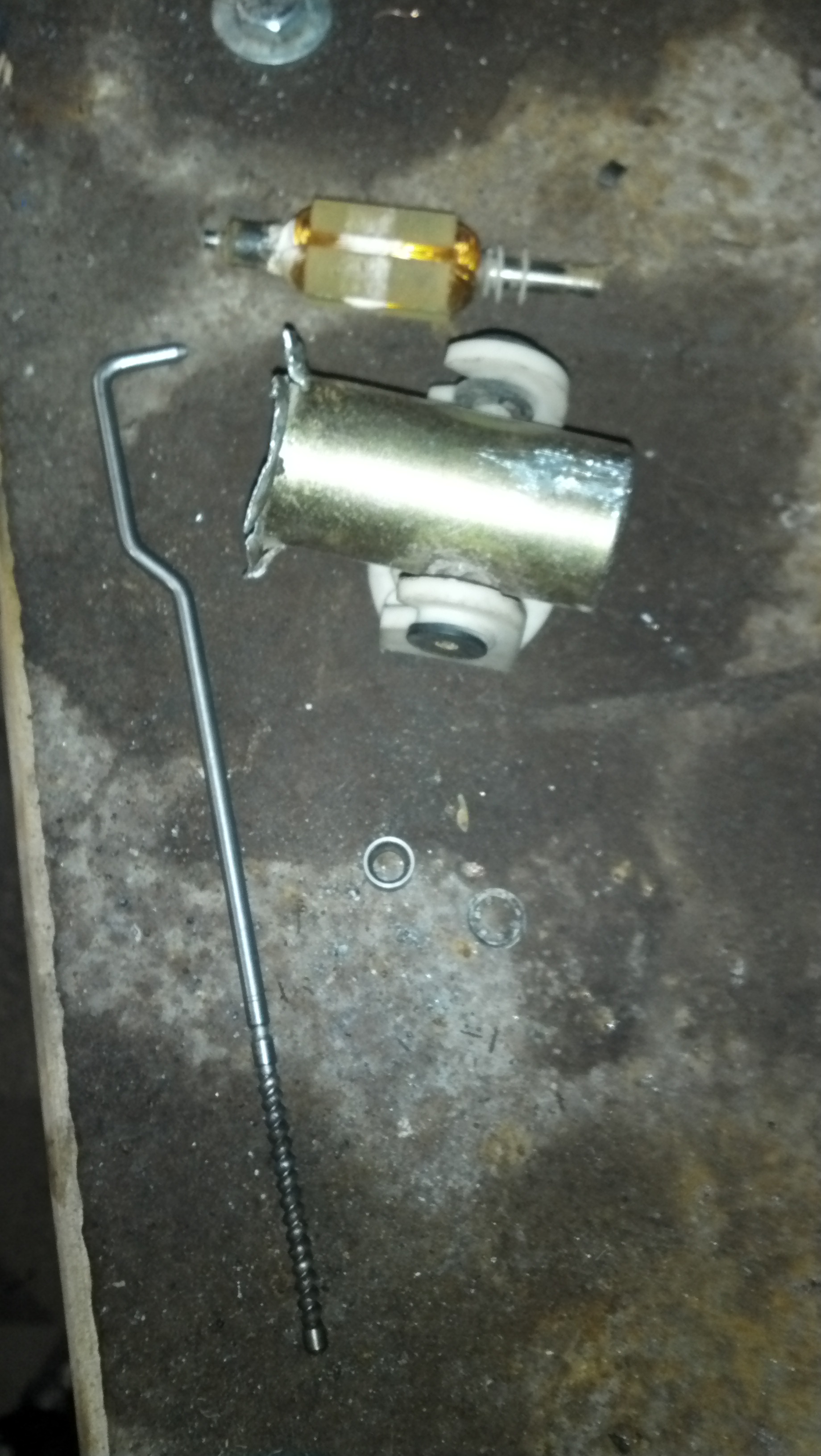

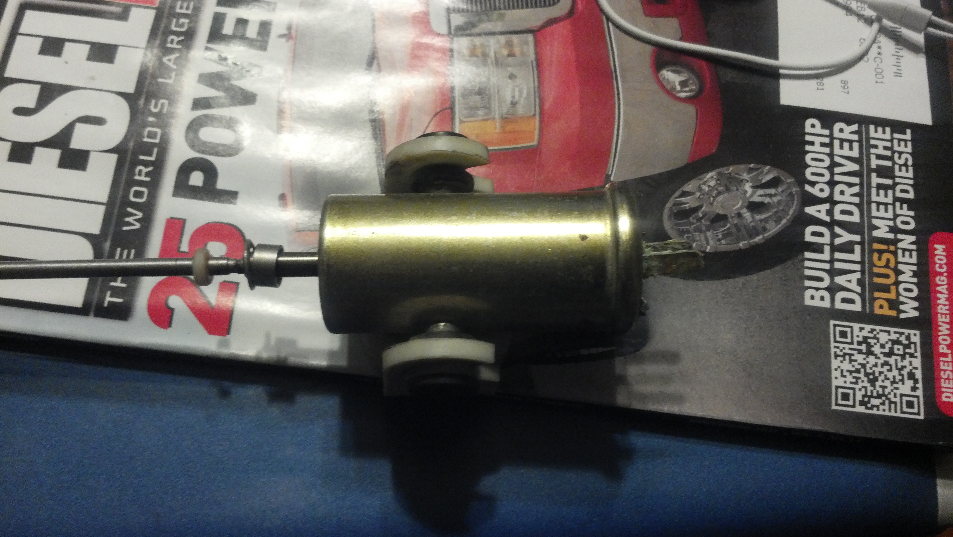

Well, I did some research online yesterday and determined that the actuators for the rear doors in a crew cab are different from the front ones. Looking online at Ford Parts it seems that the front actuators are in the area of $95 and the rear actuators are $330! Holy Chit thats a lot of money, and I am definatly not paying that. I went ahead and ordered one off of Ebay for $7.95 that is a "Unviersal" actuator, and I think I should be able to make it work.
For the hell of it last night I decided to try and get my old one apart to see if it was repairable, and just how it worked (why it was so F-ing expensive). I used a reciprocating saw to cut slits into the crimped on part and then bent the tabs back. I was able to get the plug out see what was in it and took a few pictures. This type of actuator doesnt use a small electric motor like many of them do, this thing actually IS the electric motor, and apparently got some water in it because it was rusty as sh*t in there. I snapped a picture of the inside and then all the parts just to show what it actually is. I think its too far gone to be able to fix it, especially if I can get this one for under $10 to work.
I will keep you all updated when I get the new one on how the install goes just to get some more info out there.

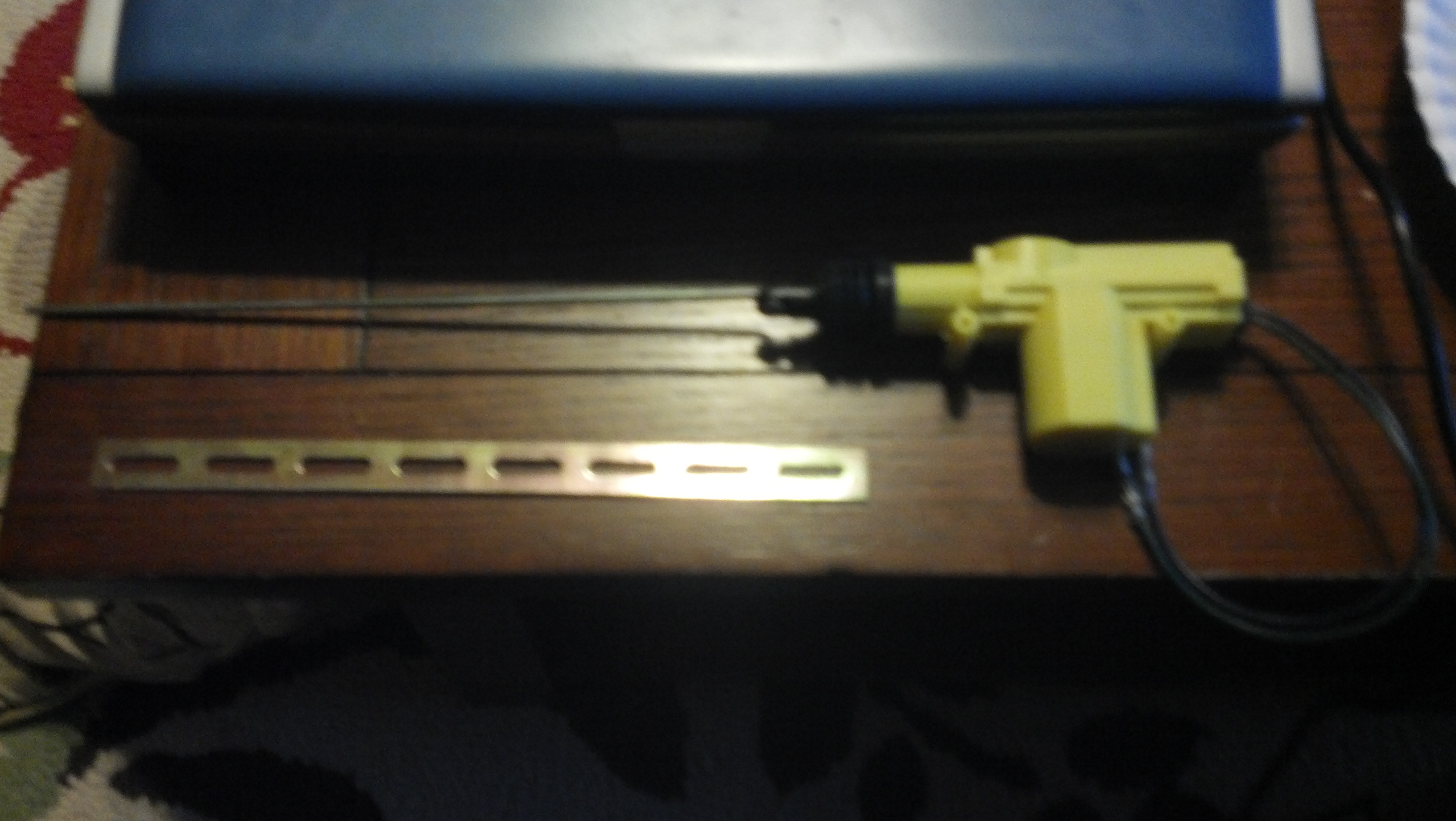

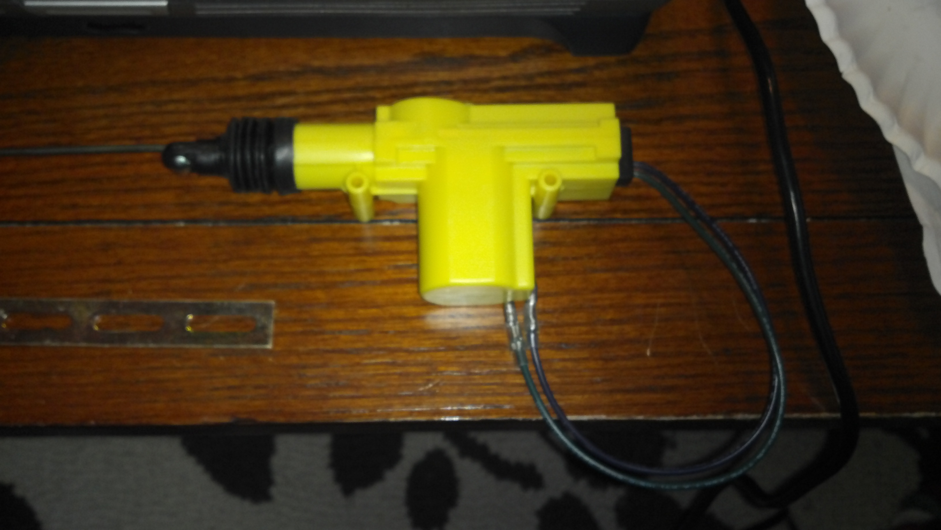

Got the replacement actuator today. We'll see if I can get to it tonight or tomorrow night. I attached some more pictures to show what the new one looks like. Should work .... the only potential issue I see would be that it seems like the old one might have a bit more travel than this. I think it will work like a champ though.

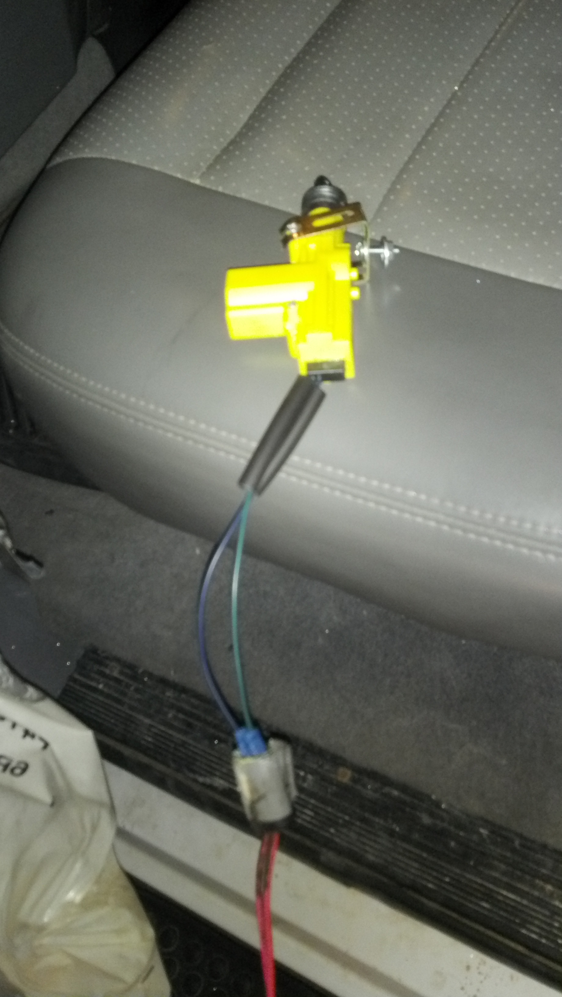

Got a little done tonight. Going to be able to leave the factory plug on it in case I have to use a ford replacement for some reason. Got it mounted, so now I just have to get the rod itself figured out and should be good to go. If people don't want this much detail just let me know. Figured since it wasn't the usual "door lock fix" I would try and help someone else out by putting up as much info as possible; since I have gotten so much help from others thought I'd try and return the favor.

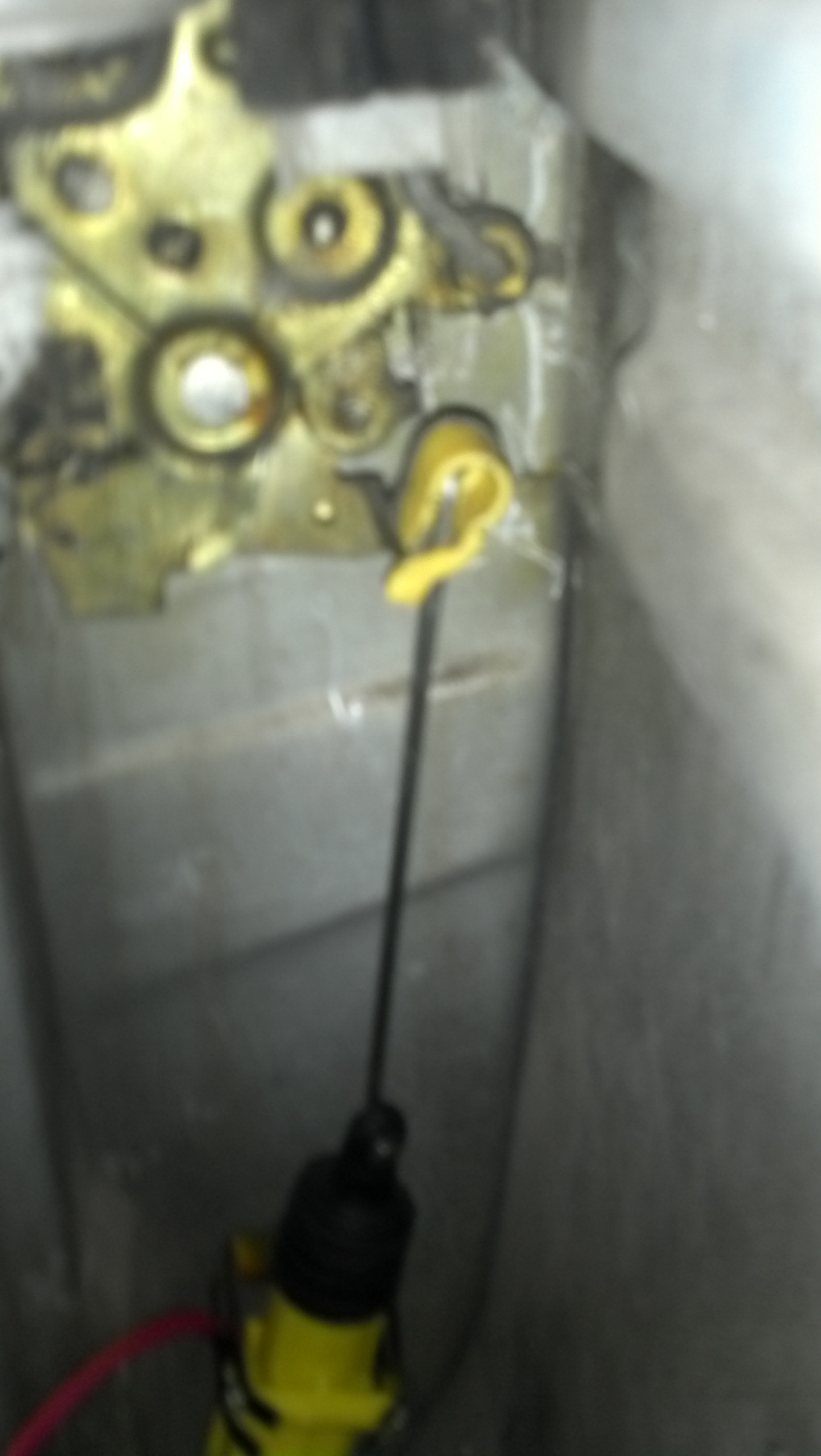

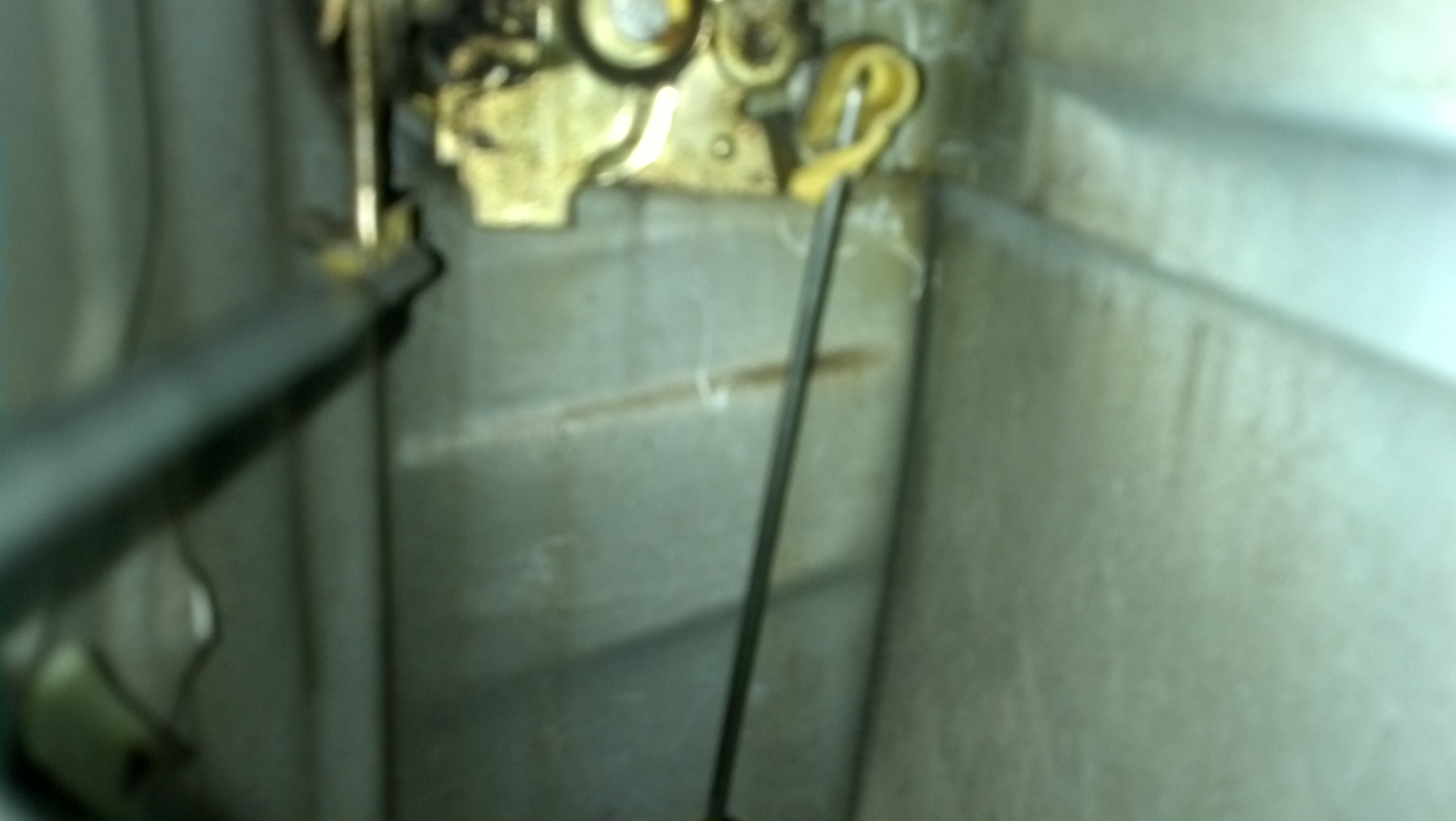

SUCCESS!!! Finished up the install tonight. Went a lot faster than I expected it to. I had it mounted in the door yesterday, but pulled it back out and used the old actuator and rod to figure out how long the new rod needed to be, so they were the same length. Some quick forming work to make the rod match, viola, it worked like a champ. I attached some pictures of it mounted inside the door, but the quality is incredibly terrible as i was holding the phone/camera blindly inside the door. Not a bad fix at all, aside from some tight spaces for working, luckily my hands aren't all that big. It took about 4 seconds of having all 4 locks functioning to lock myself out of the truck. :pointlaugh: The front door swung shut right as i was thinking ... ah crap. I am glad I finally got around to fixing it, and that it I was able to make it work fairly economically. This is one of those things that really bothers me (the locks weren't symmetrical). On a side note, why don't they have factory replacement lock rod covers at auto parts stores? Do that many people actually put skulls or 8 balls on them?
