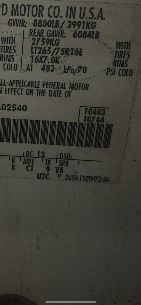

It’s on the door sticker on my SD truck. Maybe in the same spot for you. I believe that reads as v code front A code rear.

If I’m reading this right, it’s the SPR and VA code correct?
I’ll be checking mine as soon as I get back to Texas in a few weeks.

Finally got home and had a chance to get to the truck.
Has A code rear leafs.
This is 3/1 - 2600lb/spring.
Looking at comparable springs the next closest weight rating I can get is 1950lbs.
