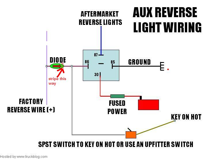

760
Dalton,NH (The White Mountains)
I did mine like this..there should not be any back feed through the upfitter if it is in the off position..
