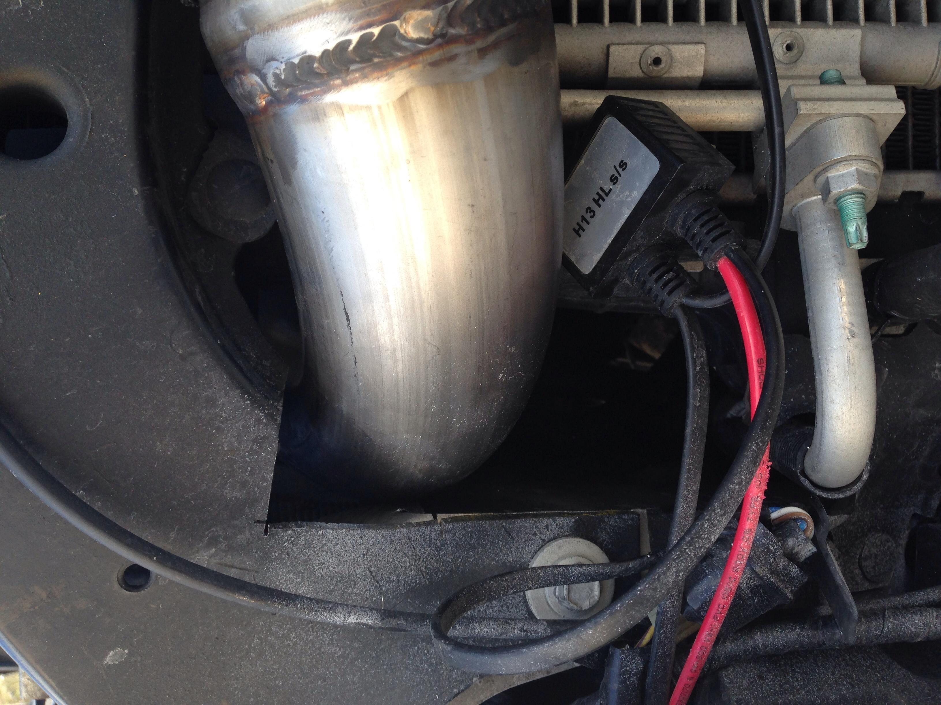

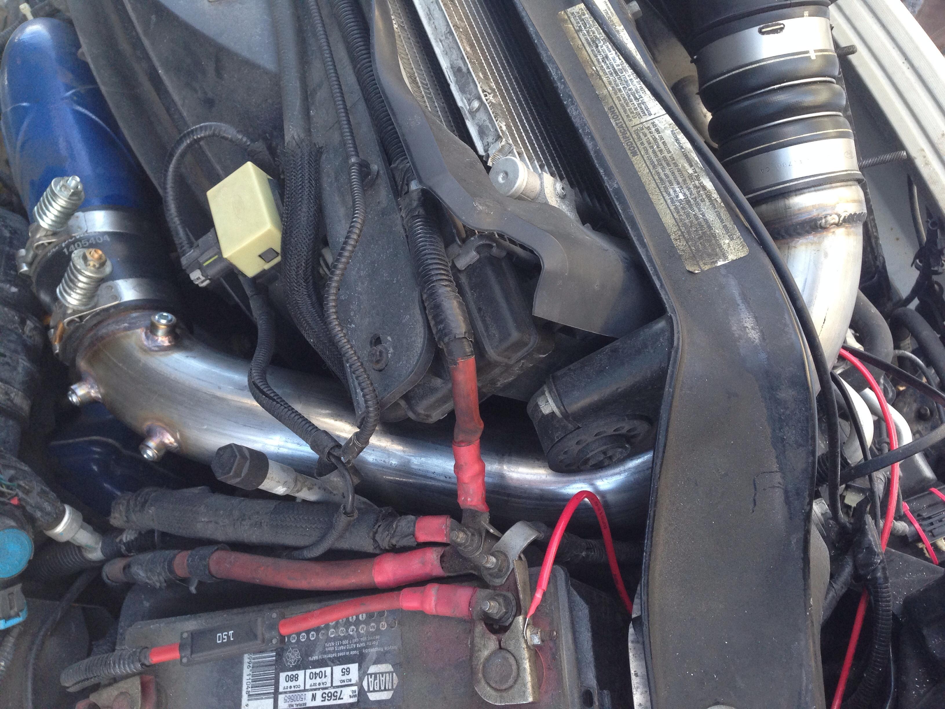

I finally was able to get around to buying something for the truck. I decided to keep it raw. was gunna paint it the same color as my turbos, valve cover/rocker boxes, and intake elbow but figured it be to much ford blue

Here's a pic from the top
