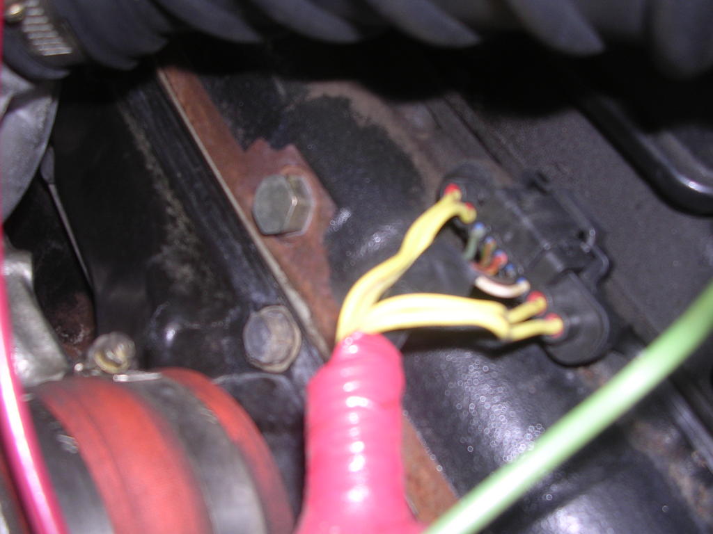

They will not fix your issue... Good to do, but will not fix it.
You gotta dumb it down a little for me what's a uvc and what does it looks like. Sorry this is all a little new to me it's my first 7.3
One on each side...

UVC harness, gaskets. Check to make sure none of the plugs are melted or anything else...
After that find someone close to you with Auto Enginuity and have them check it out.
IDM's are pretty tough items...

Sounds like your buddy should stick to something else...
All that means is that the truck went to default ICP maps...
Wiggling the UVC connection means squat.
Pull the valve covers and check them.
