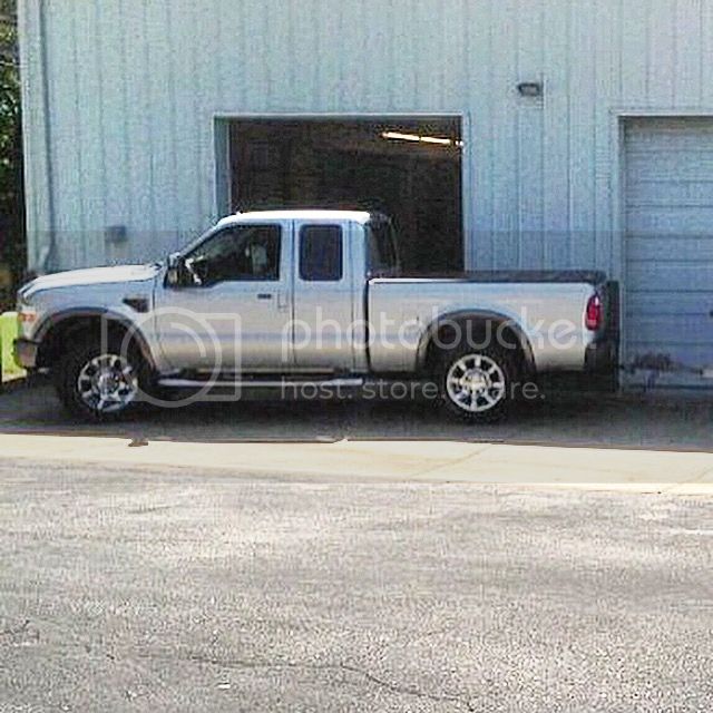

Leftthenleft
May 16, 2014
273
Nc
Couple of pictures I have gotten to photobucket. Still need to figure out how to add multiple to one post. Everytime I leace the page to go copy my photobucket url, I come back to my last image being gone. I need to try on my computer I guess.
