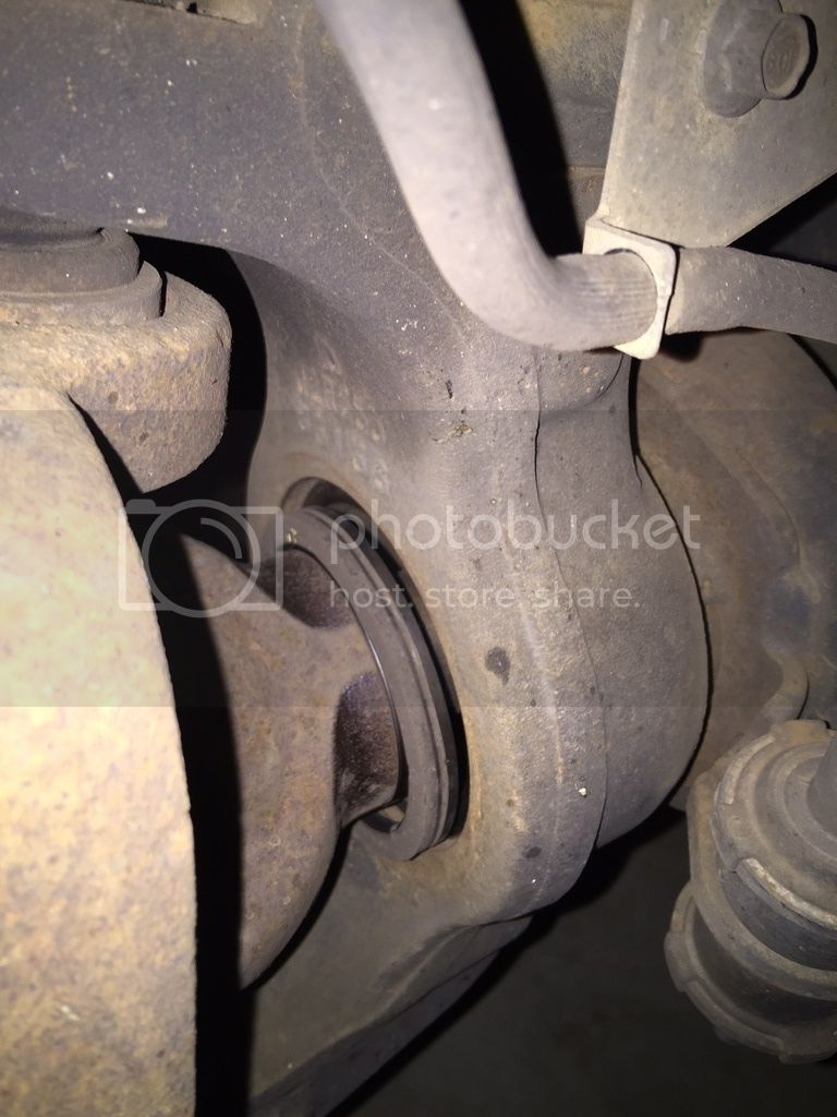

While installing a leveling kit last night, I noticed 2 seals that were spinning with the axle shaft freely and clearly not installed. I believe these are called the inner spindle shaft seals, which is just a dust shield. I tried to push them in with a screwdriver but, could not get them to set correctly. I see most installing them with a special driver tool but, to do this, you have to remove the axle shafts. Is there a way to install these without tearing apart the front axle? Does Ford have some kind of tool to re-seat them while the axle shafts are on the truck? Here is a picture of mine and both are the same.
ToddEdge
Nov 11, 2016
20
**The dealer wants $652 to replace both seals. I'm just hoping there is a way to push the current seals back into place but, they are likely original and need to be replaced...

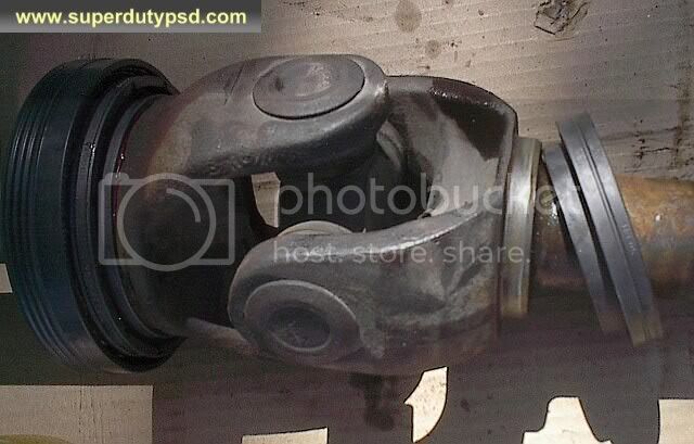

just let em flop some Danas don't have any seal there

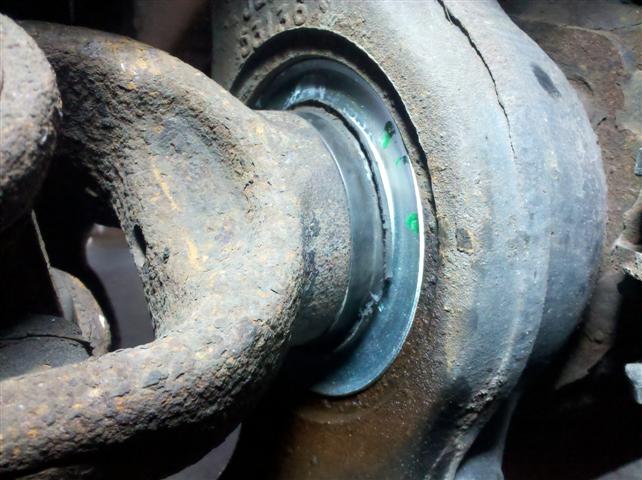

and when it comes time to do u joints or other work you can get the updated seals that fit tightly in to the axle housing vs riding on the axle shaft
Zmann
Aug 5, 2011
4,464
right side of pic = old and flopping around
new style inserts in to axle tube

The crappy flippers are 50-120 each and they do nothing. If you can get the older style ones you pound in good otherwise waste of $$.
Op- you can remove the axle shafts pretty damn easy.

Thanks guys. Sounds like I'll just cut them off and whenever I do any major work on the front, I'll get the upgraded push in style seals.
