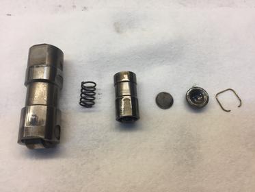

I’ve done it with a 6.0 lifter which is the same as a 7.3 lifter. I’ll get you the measurements on the rod I put inside the lifter tomorrow.

Here’s what you’ll have when you take the lifter apart.

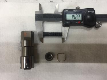

Here’s what you need to make it solid.
I used a bolt that I had, but a 3/8” rod 1.422” long works well also.
I squared the ends in a vise on my surface grinder. It is important that the ends are square so that the top plate doesn’t try to cock sideways.
