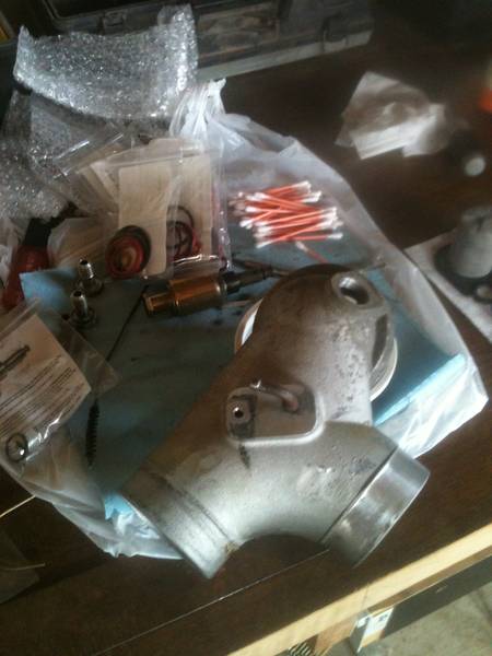

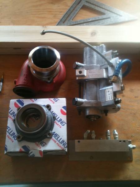

Just some things being gathered. 1.15 38r housing and van turbo adapter. Twin pumps that will be getting a dual IPR setup and some reconfiguration to 4 feed lines and deleting the single remote IPR block and non serviceable plug repairs just for insurance, custom made billet fuel distribution block and fittings to get rid of hated fuel bowl. And a new Melling LPOP. Rods are being cryoed and heat treated as we speak and cam is being or is already ground, which reminds me i still owe Matt some money. Taking a block in soon to be magnafluxed and sleeved if it checks out.

Leave it to Curtis to see pink out of orange...
I'm just going to assume you will make a rear support for that back pump. I know we had that talk... LOL

u can blame 7.3 rocket for that paint i painted it for him thinking it was a van housing
its supposed to be red according to duplicolor anyway

It is not red lol. Even my wife commented on the color when I picked it up at the post office LOL.
So I explained how you were substituting garish colors for HP. LOL
