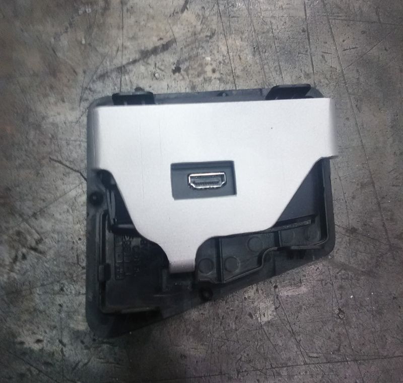

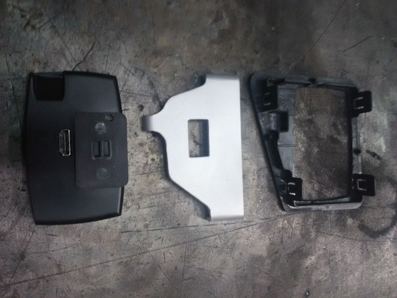

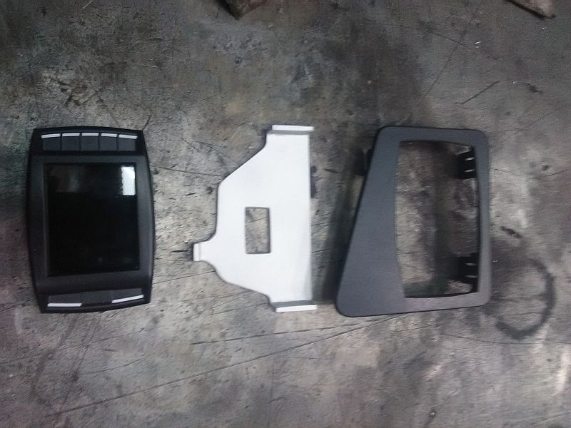

I've heard quite a few good reviews about the tuner, but the same can't be said for the suction mount that comes with it. Rather than dealing with that, I'm making a semi-permanent mount to fit in an empty space in the center of the dash. My truck is a XL model, so there are lots of unused spots in the dash to put it. I chose the little insert panel just above the 12V socket on the left for it's new home. A few minutes of quality Dremel time later and I had a Mini Maxx sized hole in the panel. To hold it in there I had to make a mount for the back of the panel. I started out by cutting the end off the suction cup mount and sanding the back side of it smooth. Today I brought those two pieces to work (machine shop) and fabbed up an aluminum bracket to mate the parts together. The bracket has a little window in the middle of it to clear the HDMI plug. I just need to drill and tap the aluminum in a few places to attach the bracket to the panel, and also attach the mount I cut off the suction cup to the bracket. I set the height of the bracket so the seam in the MM housing is lined up with the front face of the panel insert.

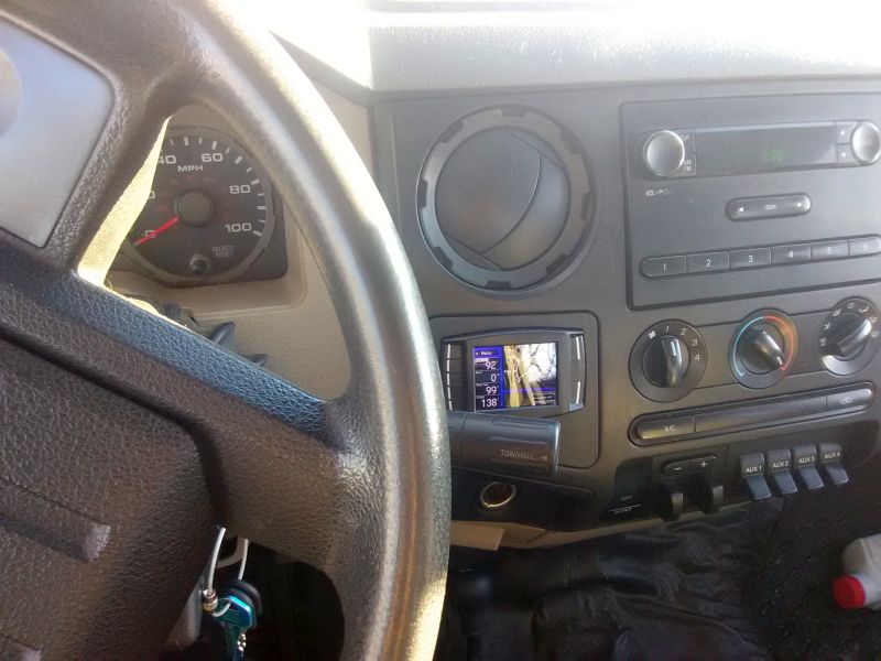

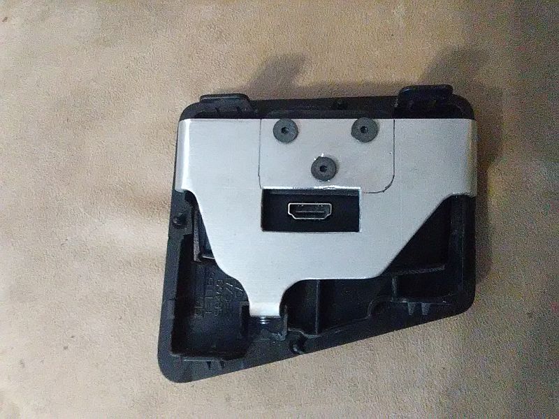

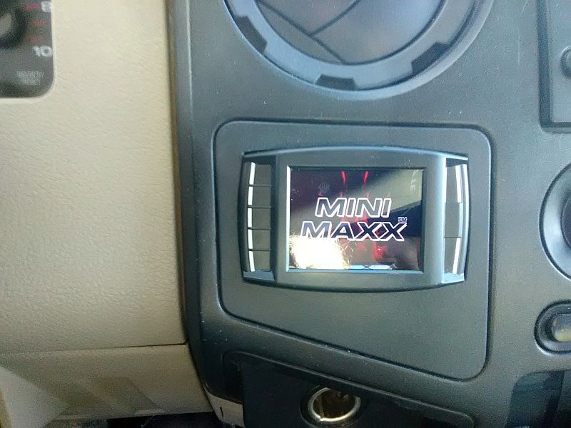

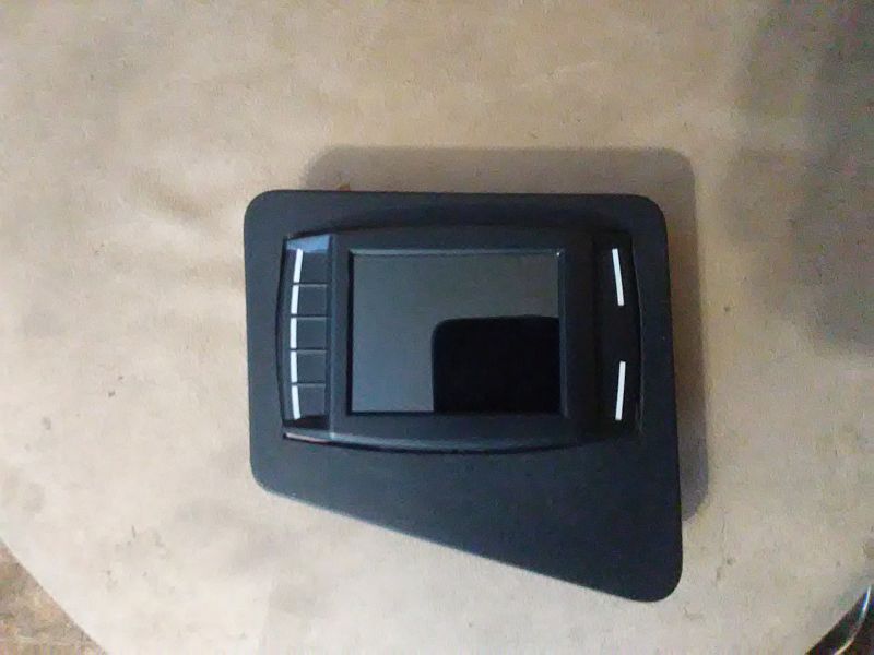

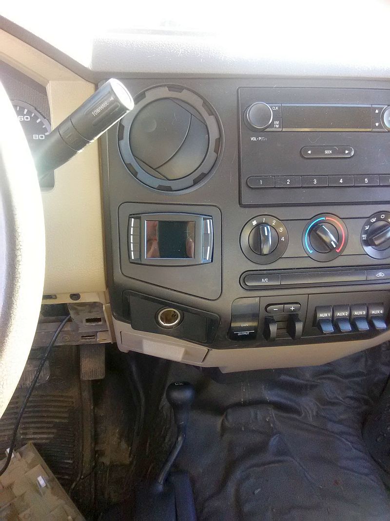

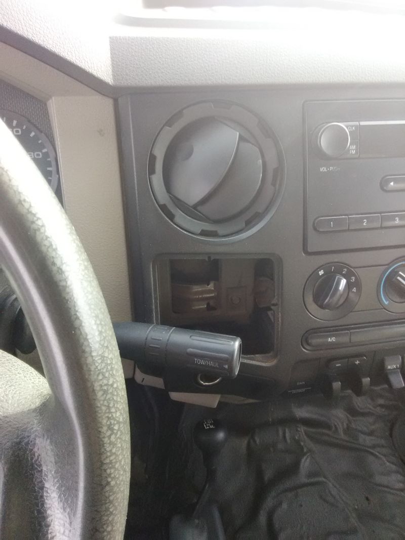

Got the tuner mount finished up today. A few of the screw ends had to be shortened, as well as one of the screw heads needed ground down for clearance. Different screws would have been better, but it was what I had on hand. I'll still need to trim some reliefs in the dash opening to clear the aluminum bracket tabs on the left and right sides. All in all it looks like it has turned out well so far.
And, as promised, here's a few new pics from today. The first pic shows a straight on view of the hole in the dash that this tuner and mount will be filling. The shifter is in Park in this pic. In the second pic I put the shifter in Drive and took a pic from the perspective of how I would see it while driving. The other two pics show the tuner mounted in the now assembled dash insert with my custom mount. I used three screws in the middle to hold the T-slot part from the window mount. Since those screws were just a tiny bit too long to sit flush in the T-slot thingy, I was able to use those same screws to allow me to aim the tuner upwards a little bit. They also dig into the plastic back of the tuner and act as a lock of sorts. It's VERY solidly mounted now.

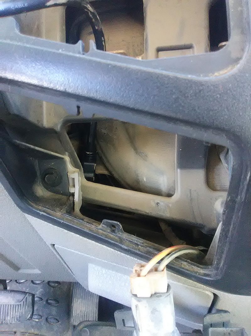

I didn't get to doing the wiring and cable routing yesterday, and now I really wish I had. I ended up getting hurt at work, splitting my thumb wide open to the bone, and then going to the ER and getting stitches. So, after work today I had to get the job done without the use of my left thumb. Procrastination doesn't pay folks...:thumbup::doh:
Anyway, that's enough self pity for one post. On to the pics! (I'll try to list the pic descriptions in the same order as the pics)
1) I started routing the HDMI cable from the tuner end first. It went over and behind this metal bracket. I ran it there since the metal edge was rounded over nicely and wouldn't be likely to cut the HDMI cable.
2) I pulled the 12V power outlet panel out and passed the cable straight on down behind the inner plastic bracket.

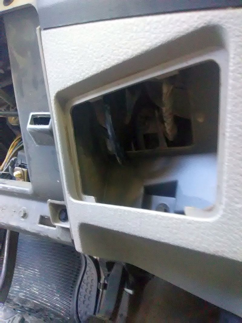

3) The ash tray and it's holder came out next. There the cable went down and then made a 90* turn towards the steering column.

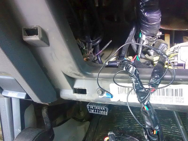

4) I removed the panel under the steering column to access that area next. The cable was fished through the inner dash a bit more until it poked out below the steering column.
5) Next I had to find the infamous purple wire. I had to move the remnants of an old alarm system out of the way before I spotted it on the left.

With the power wire located, I crimped a spade connector on it, and put the mating connector onto the red power wire. Then it was just plug in the OBD adapter box, plug in the power and HDMI cables, and finally, snap all the removed panels back into place.
6, 7 & 8) Here's the end results.

Thanks for the compliment. I hope this info can be useful for anyone wanting to install their tuner without having to stick it on the windshield or buy an expensive add on panel. I've put less than $5 into this install from start to finish.
Making the aluminum bracket was the hardest part of the whole project, and the 1/8" aluminum (thickness overkill, but it was what I had handy) was formed just using simple tools. A drill, angle grinder, files, vise and a hammer was all I used to shape it. To mate the bracket to the plastic panel, I used a drill and a tap to thread it. All the panels I removed were snap in and required no tools to remove or reinstall.
The only thing I don't like about it is how glossy the screen is in bright daylight. You can see what I mean in the last two pics I posted. I may look at sticking a cell phone screen protector on it if it bugs me too much. Some of those usually have a matte finish to the surface.
