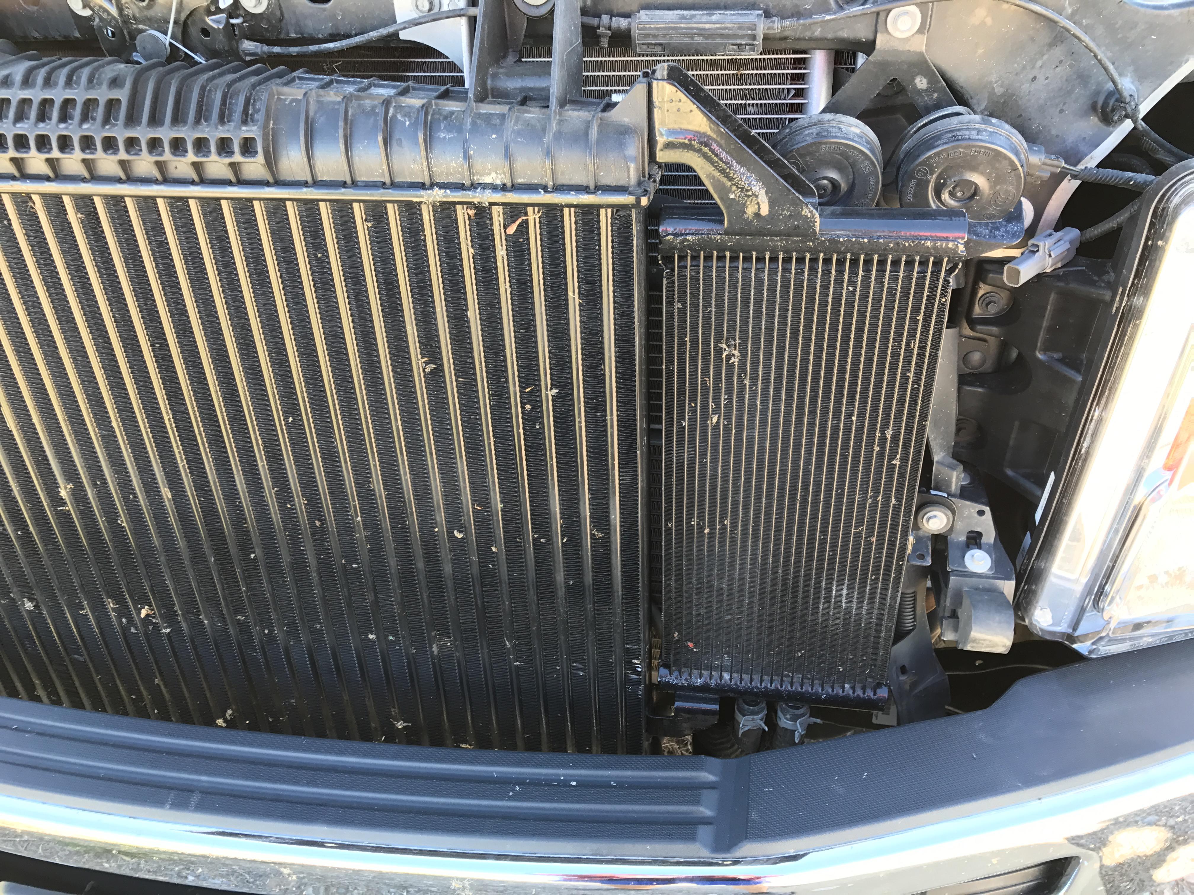

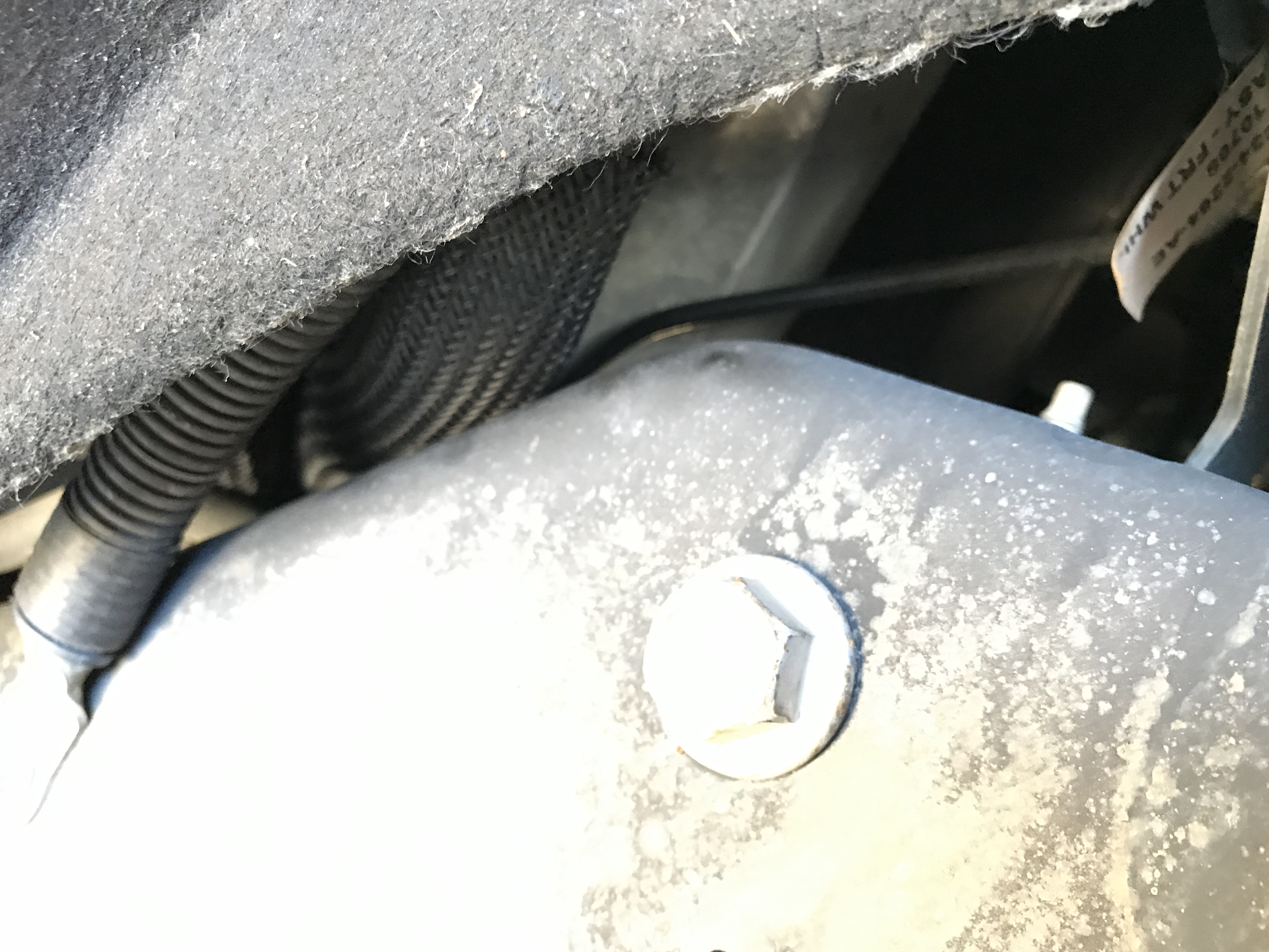

So it's been about 6 months that my 6.4 was wrecked and the front end was replaced and after picking it up it started making a squeaking air leak type sound and I finally found out where it's coming from. In the photos there's a hose that runs in the drivers side wheel well and it goes to the cooler on the right and if you grab it you can feel it vibrating. It doesn't always make the sound and will turn on and off while it's running. It's driving me crazy so if anyone knows what it is and can let me know I'd greatly appreciate it.

You have air in your fuel coolant system. Put the tail in up in the air as high as you can. There's a plug on the top of the VGT actuator to bleed the air. Fire truck up and let it idle. Burp and slowly refill up by the fuel cooler until noise stops and no more air bleeds out.

That's the fuel cooler. Do a search on here, there is a procedure to bleed the system
Thanks!
Thank you! Should I strap it to the bucket of the tractor by the ass end and stand it on its nose? LOL
