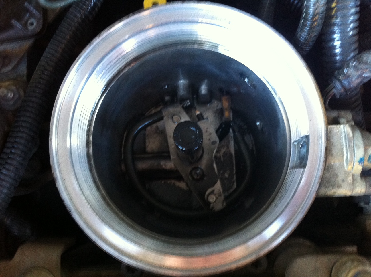

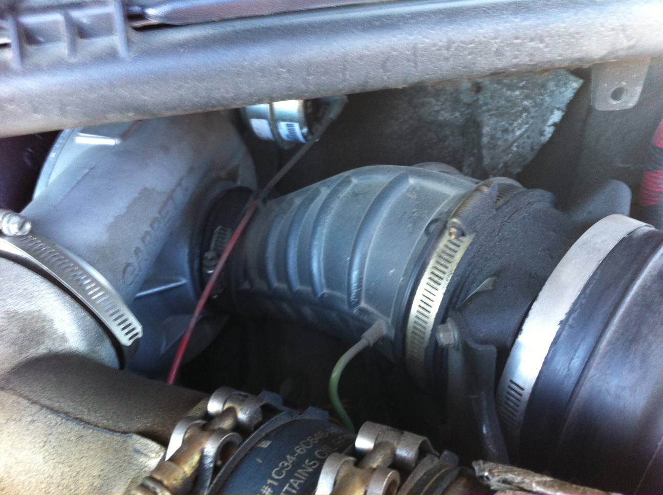

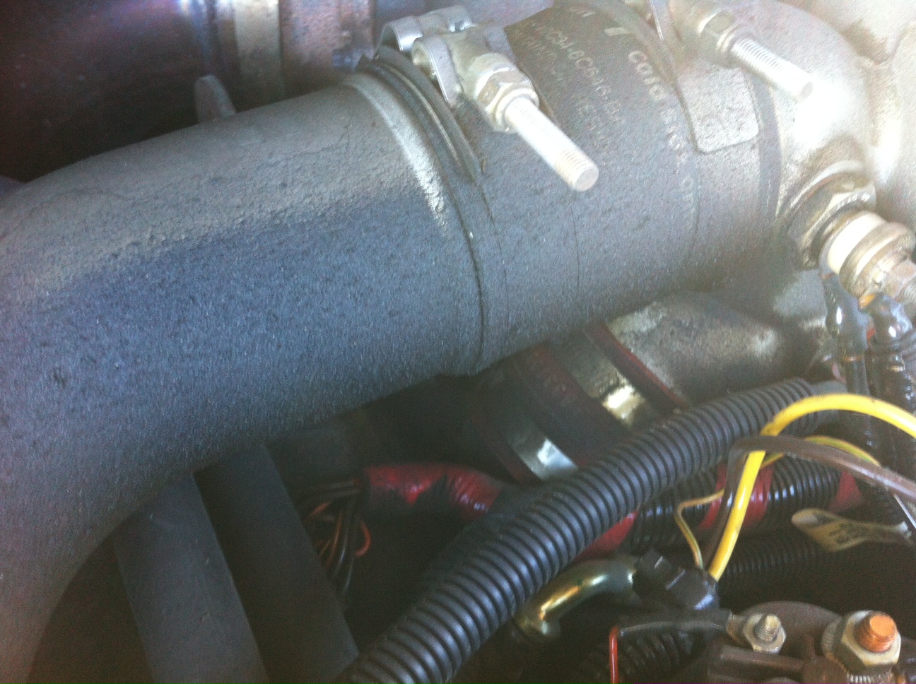

I just went out and swapped out my EBPV sensor and fuel filter. I took a couple of photos of some of my boots. is the oil on the tubes and the staining on the spider a sign that those boots are leaking? Seems to me it is.
Also, the shot of the inside of the fuel bowl is showing a lot of "grime". Is there a good way to clean this out?

Oily boots are from your crank case being vented back into your intake. The grime in your fuel bowl can be from crap in your fuel tank. It just develops over time. I would pull the bowl, and give it a good bath to get it cleaned well and assure no crap goes to your fuel lines and into your injectors
