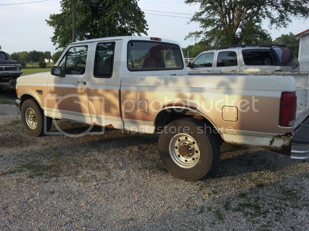

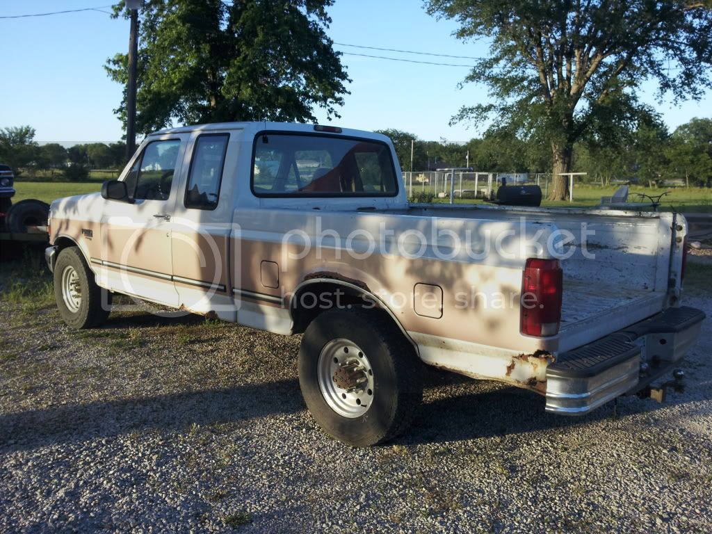

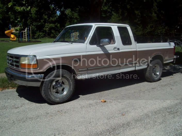

This is evidence that a GOOD vehicle can become family.
96' ecsb auto 2wd 311k paid $1750 3 years ago.
Pulled its guts out over these 3+ years. Only fixes have been regular wear items, vac pump, bat, tie rod end....ect. Thought the tranny was done last summer then 2 qts of Lucas to swell the seals and it lives again! Its rusty dented and dirty. It gas been treated like a good pair of work boots and it shows. I should just scrap the damn thing but I can't. That would be like shooting your favorite dog, and I simply can't do it. I've been tossing around for the last few months what exactly to do with it and I finally have some ideas.
Its light, about 6k w/my fatass. So it wouldn't take much to make a stealthy little sleeper/DD out of it. Something I can still pull to the scrapper + bracket race at the occasional show. Its gonna need a tranny rebuild anyway and the hpop/injs are getting week sooo.... But what injectors, what pump? Whatever I do its gonna be cheap and utility minded. It needs to still get good mileage and pull up to 20 gross.

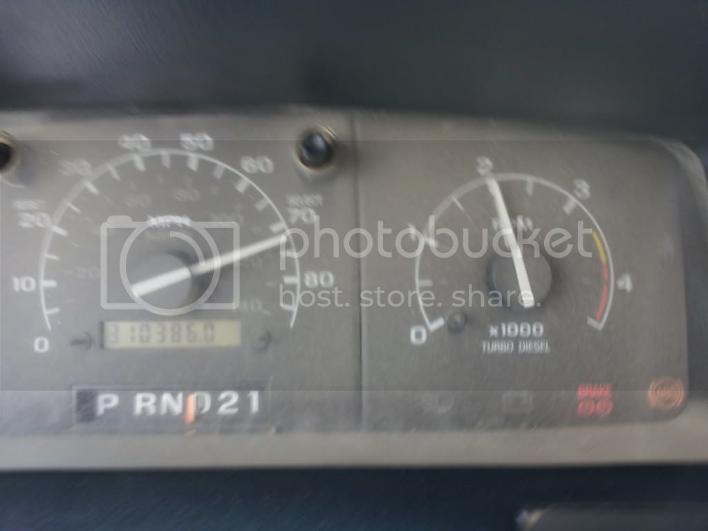

My 1st IDM mod.
And an old TS chip with TW tunes.

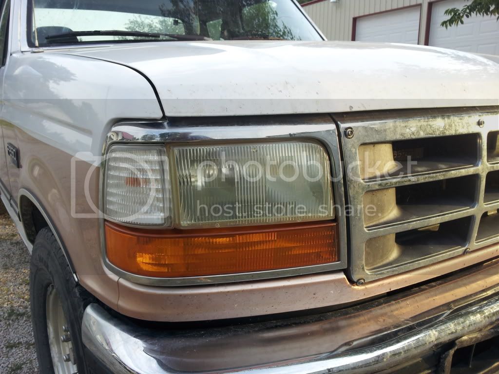

"Off mod" on the headlights.

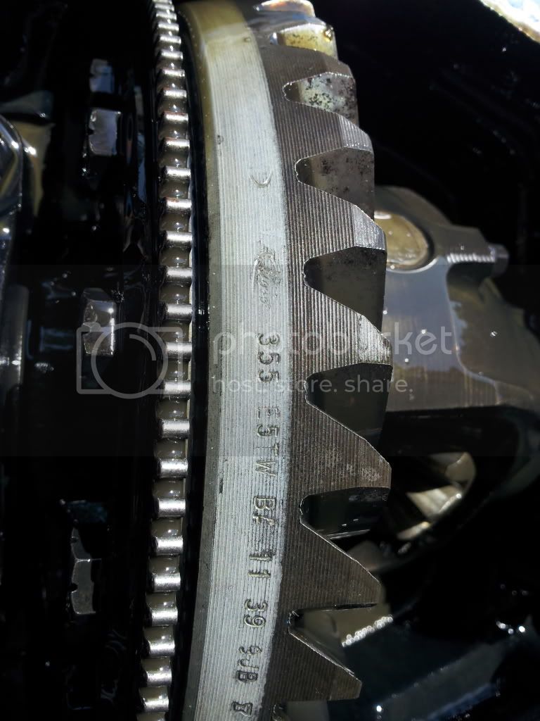

It came with a ls 4.10 rear which was killing me on the hiway. This weekend my son and I swapped in a peg leg 3.55.
Muuuch better!
