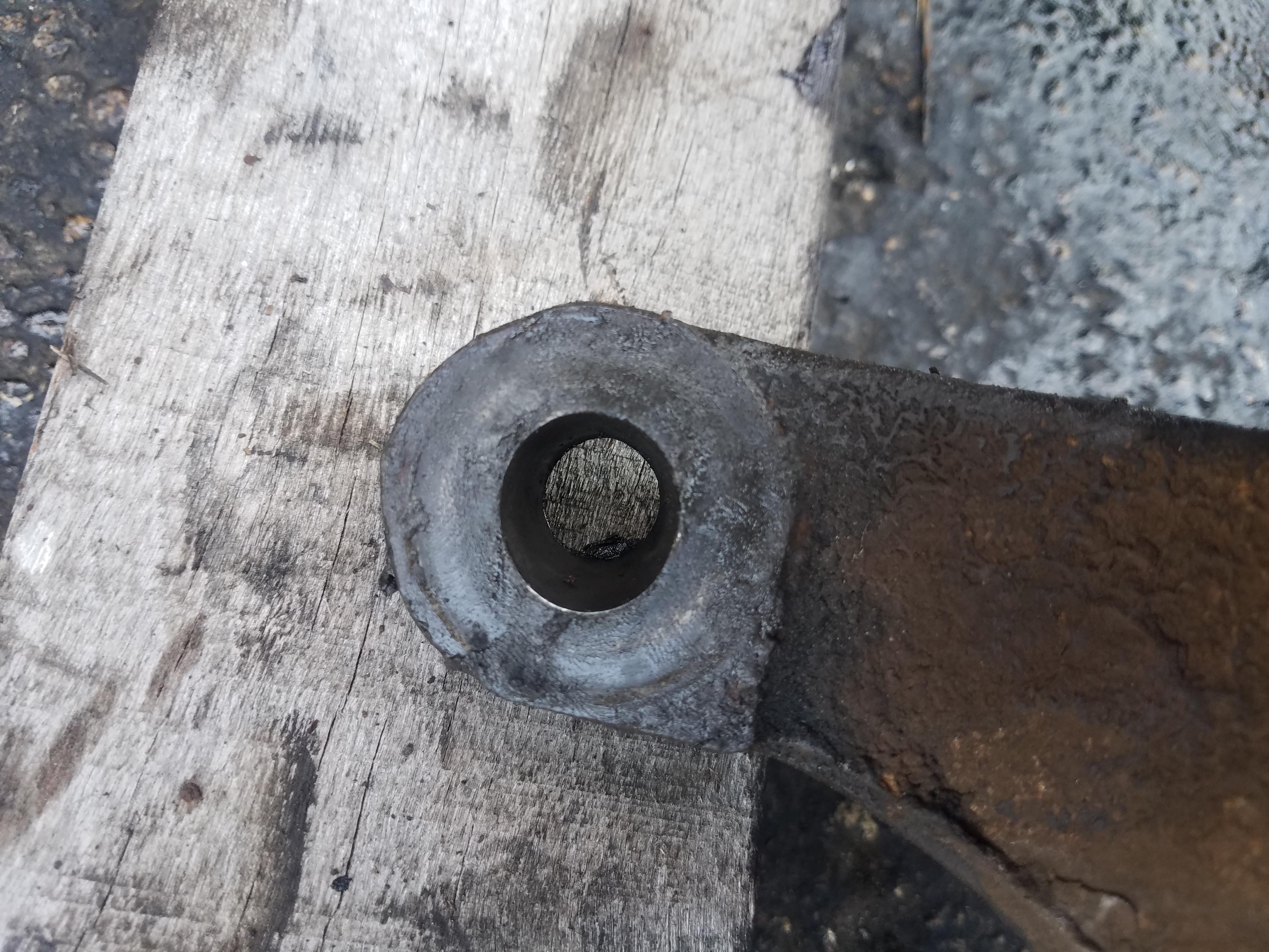

There she is LOL

Can't get a used one at the boneyard?
just for curiosity.... have you looked up how much a new one is?
