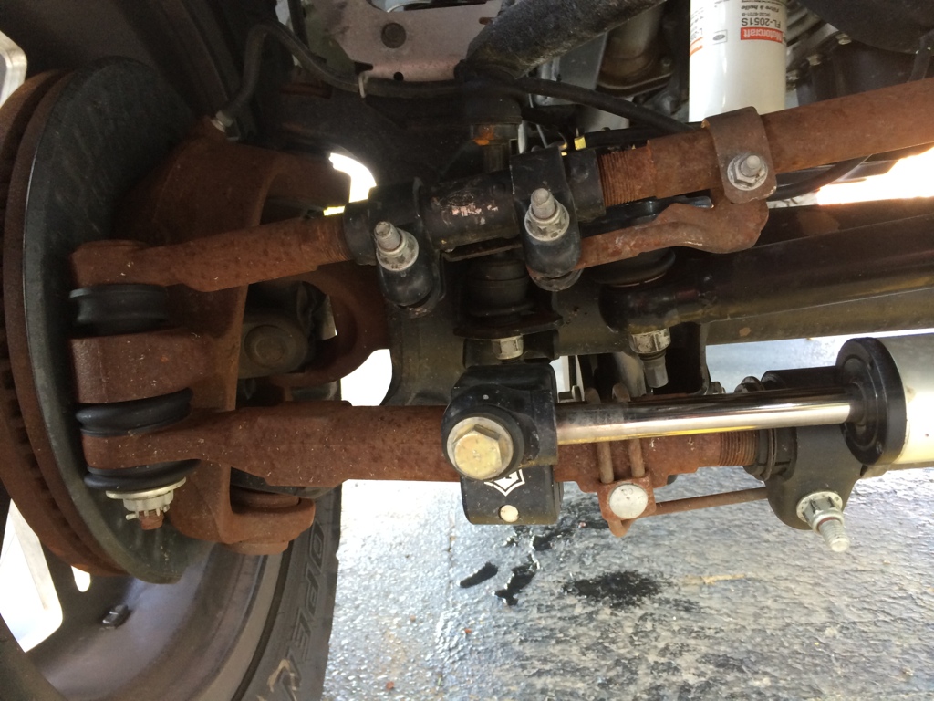

what do you mean it "goes to the right" ?
If you are saying that while driving straight, the steering wheel actually look as if you are turning right you need to adjust the drag link.
I cant find a picture, but its on the passenger side. Looks like a turn buckle. Its got 2 nuts you need to loosen (11mm I think) and you will then turn it until the steering wheel is straight. Once you are happy with the steering wheel orientation lock it back down.
Spatel23
Moderator
6,010
Olive Branch, MS
Took a pic of mine.

Make sure the align specs have at least 2degree caster. Usually should be .5-1.0 higher on rite. I put a level kit on mine and blocks. Technically caster was within spec but way too low. Almost 0. That gives u high speed instability and loose steering. On non pwr steer car it is exactly opposite . The steering wheel adjust yes what u do I set wheels straight ahead . Loosen both 15 mm nuts and the 13mm jam rod. Spray w pb n work it with a buddy looking at wheel in truck. As u spin u will be going the right way or wrong. Re-check. When straight drive and fine tune. This has absolutely nothing to do with actual alignment but is performed after align done is just part of the service. Sometimes can be a pain to get the sleeve movin. Dnt squeeze too hard on sleeve by slot of it will bind rite away. Lemme knw if I can help more . Get a printout of the align when done and check caster. Post and I will look over it. I had to put in 2degree cams to make mine rite. I have since done 3 exact trucks and rite off the bat it was same scenario. I dnt work on diesels per say but got a run of em after people saw my truck.

Just because the truck drives straight doesn't mean it's rite. Hell it can drive straight and wheel be straight and still not be rite. It comes down to drive ability (meaning how responsive /darty etc) this is wher a real front end tech steps in. Green does not always mean good. I'm trying to help and I guarantee I can walk u thru the problem but I need numbers. What is the caster reading?? I had problems and still do keeping wheel straight as fords drag link design has been an issue for a lot of years now. I found that u need to tighten the piss out of the trac bar bolt as we'll. and bushings need to be tight! Post some numbers
