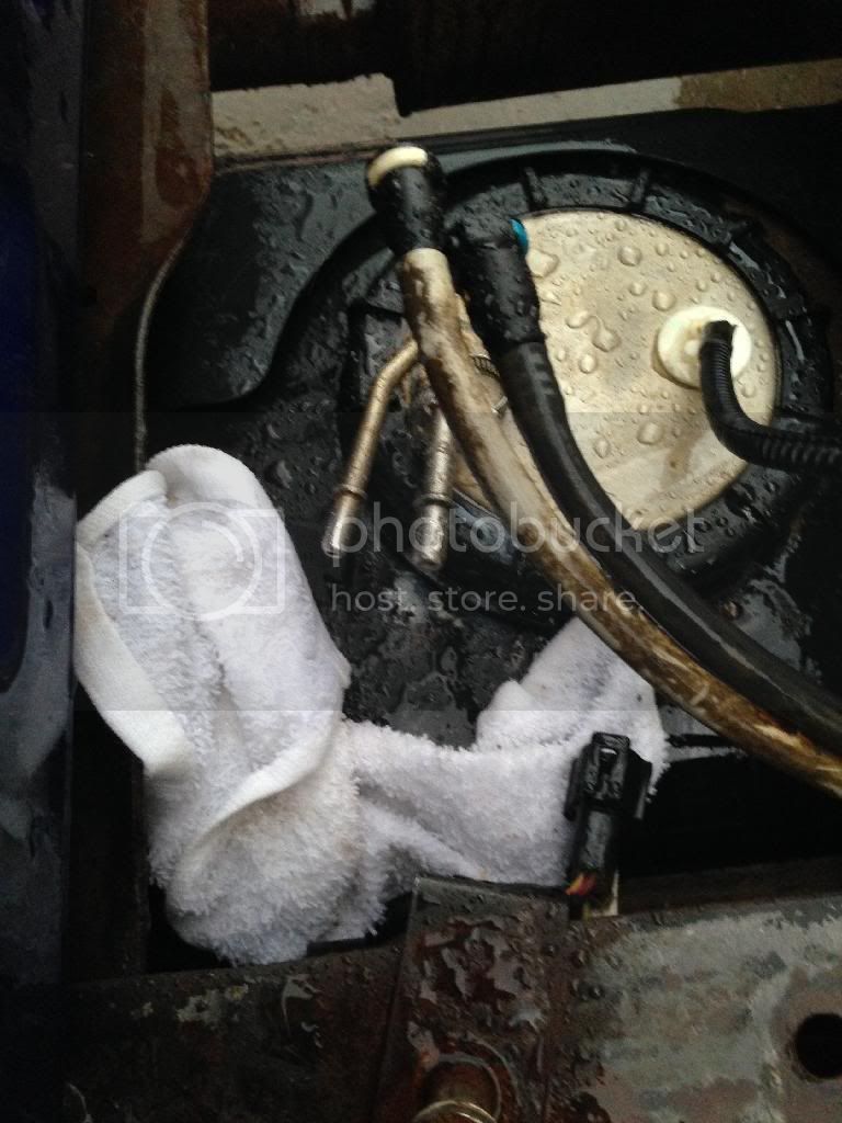

[/URL][/IMG]
Cycle_xpressions
Apr 3, 2014
21
Just as a follow up incase someone in the future needs this thread I ended up grinding just a little bit off the flange. The hose still did not push all the way forward as it does I. The instructions but it was far enough to get the second clamp on.
